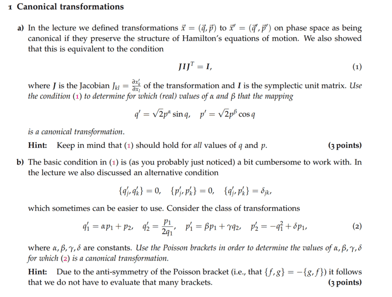

Hi,
unfortunately, I have problems with the following task
I first tried to calculate ##JIJ^T##.

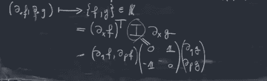

Then I took the following relation from my professor, I hope you can read it well.
and get the following

Unfortunately, I am not getting anywhere now, because in order to show which values ##\alpha## and ##\beta## must assume in order for it to be a canonical transformation, I would have to get the symplectic unit matrix again, but with my calculation I would only get numbers as entries in the matrix and not unit matrices, as it should be.
My professor's script contains the following formulation

Hi @Lambda96. I’m no expert, but (since you haven’t any other replies and I may have seen where you are going wrong) here goes...
What you have written suggests that you are trying to apply a general format to construct equations for systems with 2 or more degrees of freedom. But the problem is simpler than that.
The given transformation equations (for ##p’## and ##q’##) show the system has only one degree of freedom (so the phase space is 2-dimensional).
That means ##\vec x## has only two components, ##x_1 = q## and ##x_2 = p##.
Similarly ##\vec x’## has only two components, ##x_1’= q’## and ##x_2’ = p’##.
The Jacobian tranformation matrix,##J##, is 2x2.
For example ##J_{11} = \frac {∂x_1’}{∂x_1} = \frac {∂q’}{∂q}##
Since ##q’ = \sqrt 2 p^α \sin q ## then ##J_{11} = \frac {∂q’}{∂q}= \sqrt 2 p^ α \cos q##
Similarly, you need to find ##J_{12}, J_{21}## and ##J_{22}##.
The corresponding symplectic identity matrix, ##I##, is also a 2x2 matrix (the elements are simple integers).
You are dealing only with 2x2 matrices (but still probably have some messy working ahead!). Multiply-out ##JIJ^T## and then find what values of ##\alpha## and ##\beta## are needed to make ##JIJ^T=I##.

Some hints: First of all there's only one non-trivial Poisson bracket here, which is ##a_{12}=-a_{21}## the other are ##0##, because ##\{Q,Q\}=\{P,P\}## for all phase-space functions ##Q(q,p)## and ##P(q,p)##.
Finally you need two equations to solve for ##\alpha## and ##\beta##. After simplifying your equations for ##a_{12}## a bit, you'll see that one equation follows from the demand that the right-hand side must not depend on ##p##. After solving for this, ##a_{12}=1## gives the 2nd equation.

Regarding task b, I still have a question, if I have now understood correctly, the system has two degrees of freedom, must the Poisson bracket then be calculated as follows?
$$\Bigl\{ q'_j, p'_k \Bigr\}=\sum\limits_{i=1}^{2}\frac{\partial q'_j}{\partial q_i}\frac{\partial p'_k}{\partial p_i}- \frac{\partial q'_j}{\partial p_i}\frac{\partial p'_k}{\partial q_i}=\frac{\partial q'_j}{\partial q_1}\frac{\partial p'_k}{\partial p_1}- \frac{\partial q'_j}{\partial p_1}\frac{\partial p'_k}{\partial q_1}+\frac{\partial q'_j}{\partial q_2}\frac{\partial p'_k}{\partial p_2}-\frac{\partial q'_j}{\partial p_2}\frac{\partial p'_k}{\partial q_2}$$
I have tried to determine ##\alpha, \beta, \delta, \gamma## by calculating the following
$$\Bigl\{ q'_1,p'_1 \Bigr\}=1$$
$$\Bigl\{ q'_2,p'_2 \Bigr\}=1$$
$$\Bigl\{ q'_1,q'_2 \Bigr\}=0$$
$$\Bigl\{ p'_1,p'_2 \Bigr\}=0$$
With this I found out that ##\gamma=1##, ##\alpha=0##, ##\beta=0## and ##\delta=0## but since I got so many zeros I don't know if I defined the Poisson brackets correctly?

unfortunately I did not have so much time yesterday to add my complete calculation, my calculations are as follows
$$\Bigl\{ q'_1,p'_1 \Bigr\}=0 * \beta - \alpha * 0 + 0*0-1* \gamma=-\gamma \rightarrow \gamma=-1$$
$$\Bigl\{ q'_2,p'_2 \Bigr\}=-\frac{p_1}{2q_1^2} \delta + 1 + 0*0-0*0=-\frac{p_1}{2q_1^2} \delta + 1 \rightarrow \delta=0$$
$$\Bigl\{ q'_1,q'_2 \Bigr\}=-0 * \frac{p_1}{2q_1^2} + \alpha \frac{p_1}{2q_1^2} + 0*0-1*0=\alpha \frac{p_1}{2q_1^2} \rightarrow \alpha=0$$
$$\Bigl\{ p'_1,p'_2 \Bigr\}=0 * \delta + 2\beta q_1 + \gamma*0-0*0=2\beta q_1 \rightarrow \beta=0$$
$$\Bigl\{ q'_1,p'_2 \Bigr\}=0 * \delta +2 \alpha q_1 + 0*0-1*0=2 \alpha q_1 \rightarrow \alpha=0$$
Lambda96 said:
No problem, you have already helped me a lot with task 1 👍
Thank you TSny for your help 👍👍👍
I have checked my calculation for ##\gamma## again and unfortunately overlooked the minus sign, so the following applies ##\gamma=-1##
That all looks good.
What about ##\Bigl\{ q'_2,p'_1 \Bigr\}##?
Likes Lambda96
Thank you TSny, for your help and for looking over my calculations 👍👍👍
For ##\Bigl\{ q_2' , p_1' \Bigr\}## I have obtained the following:
$$\Bigl\{ q_2' , p_1' \Bigr\}=-\frac{p_1 \beta}{2q_1^2}-\frac{1}{2q_1}*0+0*0-0* \gamma=-\frac{p_1 \beta}{2q_1^2}=0 \rightarrow \beta=0$$
Likes TSny
Yes. Nice work.
Likes Lambda96
Thanks for your help TSny and for looking over my calculation 👍👍👍
Likes TSny
