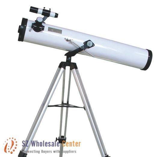

Heya peoples,
Our son Josh has just turned 9 years old and he asked if he could have a telescope for his birthday! So we have bought him an Astronomical Telescope OECSYAZ2D114/F900, Dad sat down and set it up with him and all looks great...but we can't actually see anything through the eye piece, we set the viewfinder on some stars and look through the eye piece and all is black. I've tried looking through some sites to see how to fix this but to be honest I have no idea where to start. Is anyone able to walk me through this, Josh is eager to start looking and his two brothers are showing an interest also, I don't want this interest to fade.

Hey, Tanya.
First of all, make sure you've got all the obvious bits out of the way - i.e., the main aperture is not covered with a safety cap, there is an eyepiece installed(you probably have at least two of those).
There can be a few reasons for not seeing anything.
First of all, the scope might be just faulty. Shine a torch into the tube, to see if any light gets to the eyepiece at all. Look into the tube, perhaps one of the secondary mirrors have detached or went off centre during transport.
Try using it like binoculars - that is, pont it at something faraway during the day, and see if you can see anything at all.
If you can see stuff, and everything looks fine inside(as far as you can tell), then it could be simply due to the finder scope not being properly aligned with the rest of the telescope(often can be fixed by adjusting the screws on the finder). As a result, you're pointing the scope a bit off the target, and end up looking at a region with nothing interesting/bright.
Also, remember that the telescope's field of view is much smaller than that of the finder, so you'll be only seeing a much smaller area than the one you can see through the finder, which makes it easy to miss stuff.
Both issues can be addressed by moving the main tube around a bit, so as to catch the target in its field of view.
It's best to start by looking at the Moon, as it's a large target, so it's easy to find. It's also a spectacular sight(unlike most stars, I'm afraid - those will always be just more or less bright points).
Alternativelly, try looking at something faraway during the day - can you see
The one other thing I can think of, is that the scope is out of focus, so the object you're looking at ends up looking like a very blurry patch of dim light. Try bringing it into focus by adjusting the knobs by the eyepiece(that's all they're there for; some people may erroneously think they're for magnification). Again, best is to do it by looking at the Moon, which is so large and bright that it can't be missed.
Other things to keep in mind are: the magnification of the telescope is determined by the eyepiece focal length(should be written on each one, probably in milimetres). The shorter it is, the higher magnification, but also narrower field of view, and less bright are the objects. For that reason, it's best to start with the lowest magnification eyepiece.
Each time you change the eyepiece, you'll have to adjust focus(using the aforementioned knobs).
The sky is constantly in motion, so whenever you find an object, you'll have to use the knobs by the mount to track it, else it escapes the field of view.

Hi Tanya
Nice looking starters scope :smile:
You can see 2 caps on the scope as suggested in earlier posts
one over the top end of the main tube and one in the eyepiece holder
What eyepieces did you get with it ? ... they will have that written on them
eg. 8mm and say 20mm something similar to that
pick the higher value one the one up around 20 mm as this will give the lowest magnification
and slide it into the eyepiece holder ... there is likely to be a small thumb screw to GENTLY tighten up to hold the eyepiece in place
The do as suggested in earlier posts and take the scope outside in the daytime and aim it at some trees/ buildings etc
See on the eyepiece holder there are a pair of knobs, they are the focuser knobs ( connected together by a shaft) Gently turn the focuser ( one direction or the other) till the trees/buildings come into focus.
Now its quite probable that the finder scope needs aligned to the scope, so they are both point to the same object. To do this, once you have the imaging and focusing sorted out and can see things ... aim the scope to a small object ... say an insulator on a power pole etc
centre it in the eyepiece view. Then slightly loosen the screws of the finder scope and gently adjusting them to bring the same small object into the centre of view in the finder scope.
whilst doing this, look through the main eyepiece often to make sure you haven't bumped the scope and lost the object in the main view.
Once the finder scope is aligned, THEN you can use it at nite time and start finding objects in the sky :smile:
Finally ... if all this fails ( its not too difficult) get in touch with a local astronomy club, take the scope to a meeting and have some one there set it up for you :)hope that helps

Good evening peoples,
Firstly a huge thank-you to Bandersnatch, Drakkith, AlephZero, and Davenn for taking time out to help me with this, really is heart warming!
Righto, shined the torch and we have light, checked all areas for film or covers, ( LOL- that would so have been a me moment!) found an object during the day and focused on it, put the 20mm eye piece on; Davenn we received a H12.5mm and a SR4mm eye piece, and a Barlow Lens 3x. We also attempted to align the finder scope! Now because everyone and all that I have read is telling me the moon is the best first object to explore I've convinced the boys to wait until Thursday when we have a full moon! As we are in Australia, (unfortunately nowhere near Tuscon Arizona) only 2 nights away...So I'm thinking I'll have a go while the kids are in bed and make sure it's in great working order :)
