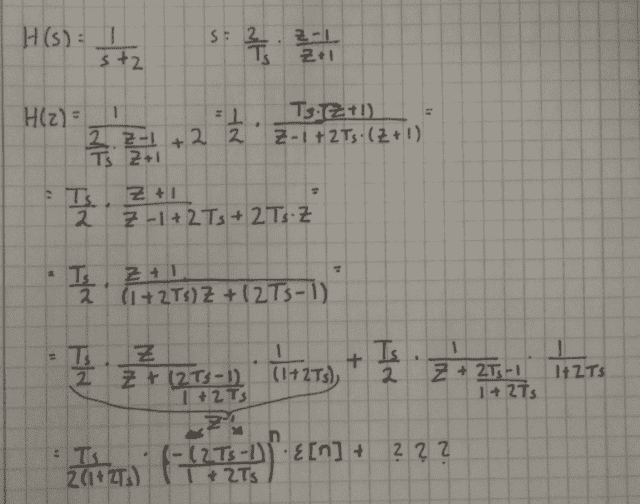

I got the laplace transfer function H(s) = 1/(s + 2) and I'm suppose to find the inverse Z transform by first converting to H(z) by s = Ts/2*(z-1)/(z+1)
Then do inverse Z-transform using the "displacement rule" - Never heard of.
H(s) = 1/(s + 2)
3. The Attempt at a Solution
I can't get any serious answer, and the partial z-inverse that I manage to find it's incredibly complicated (see image).
What is this 'displacement rule' and how do I use it here?

The solution was to, after replacing 's' with the Z components, then put all under one fraction sign (no plus in nominator). Then multiply with Z^-1 in bottom and top until you got only Z^- terms. This = Y(x)/X(x) which can then be translated back to y[n] and y[n-1] = Z^-1*Y(x)
