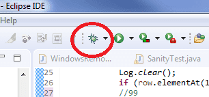

Find a good Youtube video on how to use breakpoints and this little guy called the debugger. It'll let you step through your program line by line and see exactly what your variables are doing.
242301
Likes Mark44
Hi,
I tried this debugger several times but its always a head ache. I like to learn it but break points setting and reading variable's values becomes a problem for me. Also I am working with Netbeans and not with Eclipse.
Zulfi.
It's really worth the time you spend to learn at least these two skills. I haven't written any Java code for more than 20 years, but I would bet that in either Netbeans or Eclipse, setting a breakpoint is just a matter of clicking the mouse on the line you want the debugger to stop on. And being able to watch how your variables change as you step through your program one line at a time takes a lot of the guesswork out of programming.
If you're going to write code, one of the absolute best uses of your time is to learn how to use a debugger, even if only for setting breakpoints, single stepping through code, and inspecting variables.
Likes rbelli1
For Netbeans, you click on the line and press ctrl+F8 to toggle line break on or off (or right click and use the pop-up menu). Then press ctrl+F5 to run the program in debug mode. The variables show up at the bottom of the screen when it stops at a break point.
