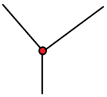

The key is to consider the forces acting on the red knot where the three strings meet. The knot is in static equilibrium. Below is a figure of the knot and the three strings. Use that as the beginning of a free-body diagram of the knot. You should draw the force vectors acting on the knot and label them. Be sure to put arrow heads on the force vectors to indicate the directions of the forces.
So if I understand correctly, you mean that I should consider that T1,T2 and T3 vectors are pulling away from the red knot instead of towards it? Wouldn't that make them go in the same direction as the m1g, m2g and m3g vectors? Or is it an error on my part to consider the masses of the objects as vectors instead of mere units of mass? Thank you very much for your help!
Yes, the three tension forces acting on the knot all point away from the knot along the strings. There are no other forces acting on the knot.
Likes TissueCulture

There are only three forces acting on the knot: T1, T2, and T3. So when you write out ∑Fx and ∑Fy, you should only use these three forces.
When you write the x-component of T1, you should write it as T1cos135o and not as -T1cos135o. If you calculate cos135o, you will see that it is a negative number. So, T1cos135o is already negative. You shouldn't add an extra negative sign in front.
However, if they had specified the angles as shown below, then the x-component of T1 would be written with a negative sign as
-T1cos45o

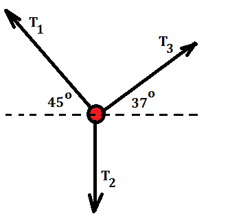

Thank you very much! in fact, both angles had to be measured in real life but I thought I had to consider the angle in relation to the positive X axis (I don't know if this is clear), so I ended up with 135 degrees. However, I suppose it is more logical or easier to go with 45 degrees now that you told me this...! What got me bugged is how I am including the weights in the equations (m1g, m2g (778.6N) and m3g). Does it seem like I'm on the right track?
Try to write out ∑Fx = 0 and ∑Fy = 0 for the knot. The only forces that should appear are the x or y components of the three tension forces.
However, you can then proceed to relate the tension forces to the weights of the three objects at the other end of the ropes. To do this, construct a separate free body diagram for each of the three objects and apply the condition for equilibrium.
You can assume that the tension at one end of a rope is equal to the tension at the other end of that rope.
Hi again! Here is what I found so far, if correct I only have one other question!
∑F = T1 + T2 + T3 (with vector arrows)
∑Fx = -T1cos45 + T3cos37 = 0
∑Fy = T1sin45 - T2 + T3sin37 = 0
1) -T1cos45 + T3cos37 = 0
T1 = (T3cos37)/cos45 = 1,129T3
2) T3(1,129*sin45 + sin37) - T2 = 0
T3(0,7986 + sin37) - 778,6N = 0
T3(1,400) = 778,6N
T3 = 778,6N / 1,400 = 556,1 N
3) T1 = 1,129 * 556,1N = 627,8 N
If the above is OK, I just wonder if the masses for the objects are equal to double their equivalent in Newtons, so: m1 = 2*T1 (in N) ??
Thanks a lot for your help TSny! :)

Your results for the tensions look correct and your work is nicely written out.
I'm not sure why you would think that. Suppose you want to find m1. Draw a free body diagram for the object with mass m1. How many forces act on this mass? What direction do they point? Is m1 in equilibrium? Do you know the value of any of the forces acting on m1?

Yes. However, keep in mind that mass is not the same as weight. So, you would not say that T1 = m1. Otherwise, I think your reasoning is good!
Yes I was about to add that in fact, the force being already known, it would rather go like: T1 = m1*g → M1 = T1/g
Which gives the mass!
Thanks a lot again for your help!
Yes, good work.
