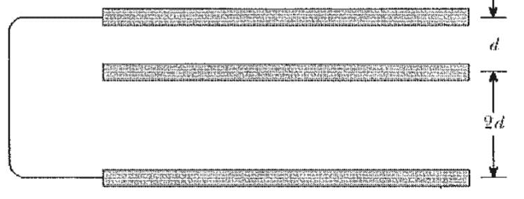

Two large parallel metal plates are oriented horizontally and separated by a distance 3d. A grounded conducting wire joins them, and initially each plate carries no charge. Now a third identical plate carrying charge Q is inserted between the two plates, parallel to them and located a distance d from the upper plate (a) What induced charge appears on each of the two original plates? (b) What potential difference appears between the middle plate and each of the other plates? Each plate has area A.
I'm not sure how to even attempt the question,
a) I don't know how the distance d is related to charge induced on the top and bottom since E fields between large parallel plates are uniform. What I do think, is that the magnitude of charge induced is equal to Q, by the principle of conservation of charge, but that's all i can come up with.
b) My intuition tells me that using the equation C = ∈A/d and C = Q/V allows me to find the potential difference.
Any help will be greatly appreciated.

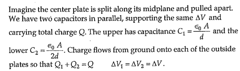

This was pulled from a PDF i downloaded. If this was in series, won't the charge on each of the conducting plates be the same?
This was the diagram from the pdf, I think it omitted the grounding of the wire. Apologies for not putting this up initially.
That seems completely wrong to me.

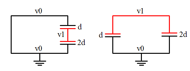

When there are only two components in a loop you can view them as being either in series or in parallel (or both!) since the connection topology satisfies the criteria of both.
It's tempting to judge a circuit's topology just by the way the components have been arranged relative to each other on paper, but it's the electrical connections that count.
Here's the same circuit portrayed in two ways simply by rearranging the component positions. All electrical connections (the topology) is exactly the same for each:
There are two nodes (potentials) in the circuit: v0 and v1.

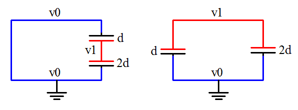

Thanks a lot, I think I'm getting the 2 nodes bit. But how exactly does this make V1 = V0 and PD across the 2 capacitors (splitting the middle plate into top and bottom components) identical?
v1 ≠ v0 . They are two separate potentials, and if you look at the diagrams they remain separate and the labels are on the same nodes in both. Here, let me make it clearer by coloring the v0 node:
Starting with the portrayal on the left, try to picture the red wire stretching and the blue wire contracting as the upper capacitor is dragged around and over to left hand side of the diagram, resulting in the portrayal on the right. No connections were changed in the process.

The ground is important because it allows the entry/exit of charge from an external source (ground). It also pins one node at a known potential, since we tend to declare "ground" to be zero potential.
So would I be right in saying:
The grounding holds the 2 plates at the same potential, and because these 2 plates are exposed to a conductor of a certain potential (sum of energy associated with all the charge pairs divided by total charge) the PD across the 2 'split' capacitors have to be the same?

Sure. You could also say that anything joined by a conducting path (wire) must share the same potential. Hence the labels v0 and v1 on the diagrams.
