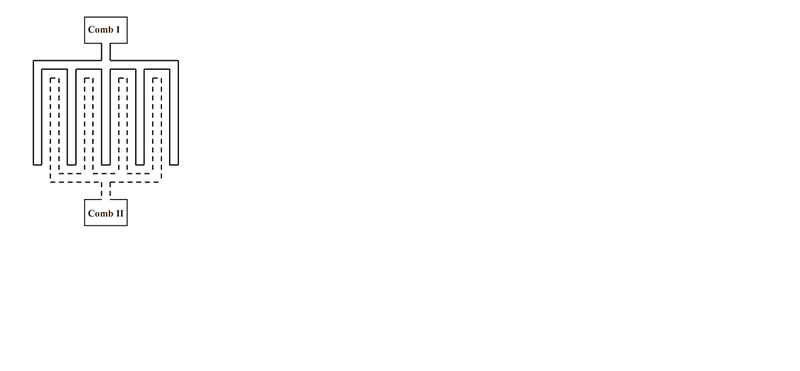

nadiaza said:can somebody give formula to calculate value of capacitance at co planar comb electrode as at the attachment..
nadiaza said:the formula you give for parallel plate capacitor but not for co plnar capacitor i think..

f95toli said:No, it is not.
What the OP is asking about is an on-chip capacitor made in a single layer of metal on a substrate (i,e, it is "2-dimensional").
Capacitors of this type are used in microwave circuits, and will typically have a C of tens of fF.
nadiaza said:can i use this formula to calculate the capacitor :
c = 2ϵw(L-x)/ g
