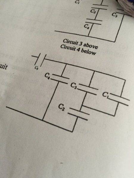

Find the capacitance of the circuit if C1 = 10.3, C2 = 41.1, C3 = 95.5, C4 = 299.9, and C5 = 525.7, with all the units being in microfarads.
1/Series Ctotal = 1/c1 + 1/c2 ...
Parallel Ctotal = C1 + C2 + ...
I tried to combine all the parallel units first and then put it together in series, but I feel like I did it wrong. The answer I got was 241.524 microfarads. I'm pretty sure it could be right given that it's less than the smallest series capacitor (the only one I'm seeing is C5), but I'm not sure. Thank you for any help!

Well, I get a different result. So one of us is making a mistake. Perhaps you can post your steps ?

Basically, what I did was:
(1/c5) + (1/[c1+c2+c3+c4])
Then let's say the result is x.
x^-1 = Ctot.
And from that, I got around 241, give or take a few mistypes in the calculator should there be.

You can combine only two capacitors in either series or parallel at a time. Start with with C1 parallel with C3..

Ah, okay. So C1 + C3 = 10.3 + 95.5 = 105.8 microfarads?
Right. Replace this parallel combination with 105.8 microfarad and proceed.

Okie doke. So now do I add that with C4 as if they are in series?

What about C2?

I meant C2, sorry! I was looking at the diagram and wrote the wrong thing >.<
So (1/105.8) + (1/41.1) = 0.0337826961 => 0.0337826961^-1 = 29.60095303 microfarads?

Right. I don't know the answer but 29.600 looks correct (it is less than the least!).
I believe you have understood the logic now. You can proceed with this technique and find the final answer. It's almost 12:30 am here, got to sleep now! Good luck:smile:!

For anyone else out there, is 202.547 microfarads the correct final answer?

Ah okay, so 202.5?
