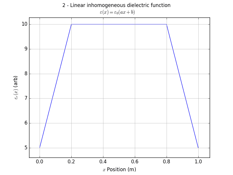

I am trying to find the capacitance of a parallel plate structure that comprises a spatially varying (linear) dielectric in one dimension. I have two methods of solving this which give different answers, and I am not sure which is correct.
I consider the dielectric region to be free of excess charge, and therefore I took the governing equation to be [tex] \nabla \cdot \varepsilon \nabla \varphi = 0 [/tex] which can be expanded to read [tex] \nabla^2 \varphi + \nabla \varphi \cdot \frac{\nabla \varepsilon}{\varepsilon} = 0 [/tex] which in one dimension then reads [tex] \frac{d^2 \varphi}{dx^2} + \frac{1}{\varepsilon} \frac{d \varphi}{dx} \frac{d \varepsilon}{dx} = 0 [/tex] Now I choose the functional form of [itex] \varepsilon (x) [/itex], where I have split the dielectric into three regions between [itex]x_A,x_{A'},x_{B'}[/itex] and [itex]x_B[/itex], shown in the attached image 'inhomogeneous_dielectric.png'. I choose the permittivity to be of the form [tex] \varepsilon(x) = \varepsilon_0 (ax + b) [/tex] in the regions from [itex]x_A[/itex] to [itex]x_{A'}[/itex] and [itex]x_{B'}[/itex] to [itex]x_B[/itex], and constant between [itex]x_{A'}[/itex] and [itex]x_{B'}[/itex] (the middle region). [itex]a,b[/itex] are different for each side region.

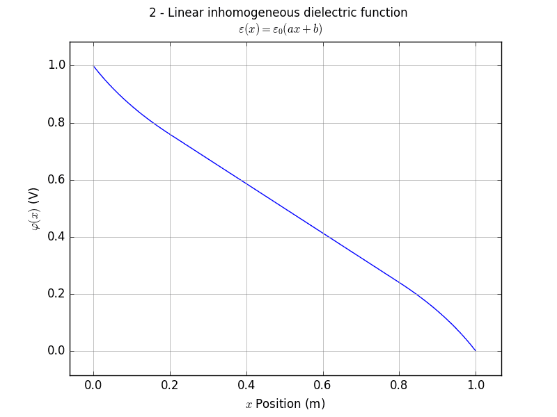

At first glance, it seems that the most obvious solution is of the form [tex] \varphi_{AA'}(x) = \pm \ln(ax + b)[/tex] however this is not very useful since there is no way of controlling the shape of this equation to match the potential at the outer boundaries [itex]\varphi_A[/itex] and [itex]\varphi_B[/itex] ([itex] V = \varphi_B-\varphi_A [/itex]). Then I notice that a more general solution is in fact [tex]\varphi_{AA'}(x) = c_1 \ln(ax + b) + c_2[/tex] which is now in a form that can be controlled.
This leads to six unknowns, which can be solved using six boundary conditions, ie that the potentials match at the outer and inner boundaries, and that the potential is smooth across each inner boundary. This appears to work ok, the result is shown in 'potential_profile.png' for [itex]V = 1V[/itex].
Then I calculate the electric flux density in each region using [tex] D(x) = -\varepsilon(x)\frac{d\varphi}{dx} [/tex] which yields a constant flux density throughout the structure from points A to B. This suggests this is the correct solution for the potential. The charge on each plate is then determined from [itex]Q = AD[/itex] where [itex]A[/itex] is the junction area.

You don't need to go through all this. Consider a slab of thickness dx. Its capacitance is
##dC = \frac{\epsilon(x) A}{dx}##. It's in series with a whole bunch of other slabs like it. What's the total capacitance of the series combination?
Likes Louis Fry
Thank you for your reply kuruman, yes using this method I get exactly the same as method 1. The potential was important to me for another reason, I went from there in my calculations but did not think of this much simpler way. Cheers!
