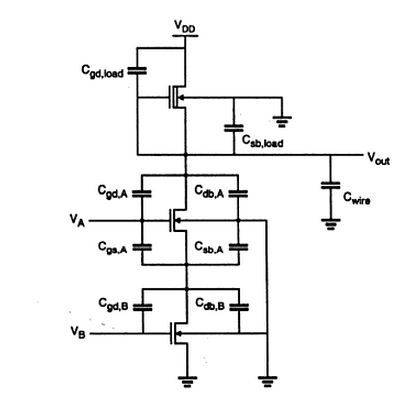

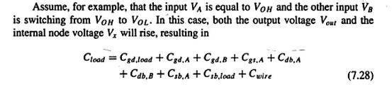

Why we are not writing Cgs Cdb in depletion mode nmos here
why no Csb in bottom nmos
Can somebody please explain how to write which components of Cload or provide some links from where i can understand it better
thank you,

There is so CsbB because the body is shorted to the source of the bottom transistor (in this circuit the substrate is connected to ground).
