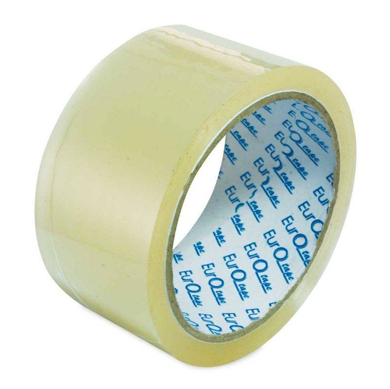

Try it with no (or very little) air in the bag. The closer the water is to the sensor the more responsive the circuit will be.
Do you get the same results with and without bag when using distilled water?
Also what is the measured capacitance of the sensor when in the bag, both when in air and submersed in water?
It had no air, I used a tape like one in image provided
I see no reason to test it with distilled water since it won't be used with distilled water and I do not have it.
Capacitance does change even when it is covered with tape or a bag. I don't have the numbers right now but that part of a sensor works just fine.
However, measured voltage does not, only when copper plate is directly exposed to water.
