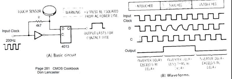

I would have thought that what you are providing is a ground with your finger. In that case I'd use the collector connected to your wire probe and the emitter grounded. When the base is grounded the collector will be high resistance and when the base-emitter is conducting, the collector will provide a low resistance to ground. If that were not reliable, I think I would use some sort of FET, perhaps a CMOS transmission gate.
I wonder if your problem is using the emitter? Even though you are not providing positive bias to the base - presumably you ground it? - if (by the capacitive charging) the wire is driven even 0.3V negative of whatever potential your base is at, then the emitter starts to conduct. Using the collector means it is non-conductive (when the base-emitter is not biased) until the collector is driven to the breakdown voltage (10's of volts) above whatever the base or emitter is held at.
If providing a switchable ground does not work, the other touch switch mechanism (probably not used in your touchscreen) is AC pickup. In that case I'd switch a signal of a few kHz to your probe.

In Don Lancaster's CMOS Cookbook, he uses body capacitance by capacitative coupling to delay an AC signal , so there's no DC connection needed.
