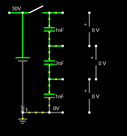

The gaps and overall voltage are given so what is each zone. Here is a logical schematic but ignore units of C which are not needed yet the dielectric ratios are critical. From Conservation of Charge flow to steady state, what is constant in order to determine the parts from the sum of 30V in 3 mm given. A simple description might be, close switch and connect meters , what are the readings? (assuming meters draw no current)

All you need is the voltage since gap is given [V/m] and equal in each zone. The only differences are series Dk or dielectric constants, ---|1|2|1|--- and Q=CV is constant for each zone and all zones in the loop by definition of Conservation of Charge.
If this simple question still does not make sense, ask a better question like what is CV1+CV2+CV3.
if V1+V2+V3 = 25V how does solving for =V1,V2,V3 yield to the answer for E(x) field in 1 mm.
Hint you do not need to solve for C but you do need to know the linear dependence on Dielectric Constant.

Then Multiply the distance of E(x) on both sides, you get 1 known and 3 unknowns.
V=E1*x+E2*x*E3*x = V1+V2+V3 like my schematic where the same charge flowed thru each dielectric to steady state so the final Q must be equal in each zone. Q1=Q2=Q3 so the answer is ??? So what are the simple known relationships between Q, V, C and ##\epsilon_r## to solve for E1,E2,E3. {x}

No the final answer is very simple in terms of V and x where E(x) has units of [V/m]
where E1+E2+E3 = 25 V per 3 mm [and 1mm = 0.001 m]
What are E1(x), E2(x), E3(x)? the 3 electric fields in 3 dielectrics ##\epsilon_R## = 1,2,1 respectively with a sum voltage of {strikeout25} 30V and equal gaps of 1mm each.

What are E1(x), E2(x), E3(x)? the 3 electric fields in 3 dielectrics ##\epsilon_R## = 1,2,1 respectively with a sum voltage of 25 and equal gaps of 1mm each.
Where do the ##25 \, \text{V}## come from? The overall potential difference is ##30 \, \text{V}##.
##E_1+E_2+E_3 = V_1/x_1 + V/x_2 + V_3/x_3 = 30V## V=Q/C all Q's are same derivedf from the same current in some unknown I= dQ/dt
and all x's = 1mm and V1=V3, Since C2 is bigger it's V2 is lower. Yes you are correct. The largest series voltage is always the highest impedance or lowest capacitance.

2C*V/2=Q
V1+V3+V2 = 2V+V/2=30 , V= 12V = V1=V3, V2= 6V thus the answers are;
##E_1(x),~ E_2(x),~ E_3(x) = 12~ kV/m ,~6 ~kV/m,~ 12~ kV/m##
