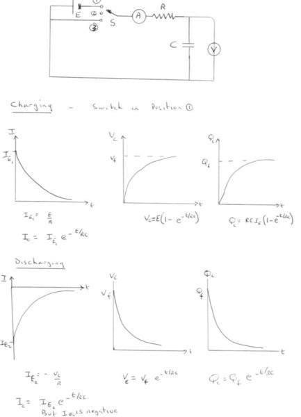

Ok so i am just trying to clarify a few points about capacitor charge, discharge, i was wondering if anyone could help.
1)In charging, am i right in thinking current decreases exponentially, charge increases exponentially, and voltage increases exponentially.?
3) Am i write in thinking in discharging, all three quantities decrease exponentially.?
4) if current decreases exponentially in charging, and then decreases exponentially in discharging how is this possible?.
5) By removing the power supply and connection to the capacitor, would it discharge, or do you have to discharge through a resistor?
Thanks in advance

You have not quite got the increase decrease or the curves correct so I have sketched some in the attachment.
note the difference betwen exponential and logarithmic increase
and the fact the the currents for charge and discharge flow in opposite directions, but the voltage and total charge graphs remain in the first quadrant.
Consider the experiment in the circuit.
A timer is set to zero and the switch set to position 1. This charges the capacitor through resistor R from battery voltage E. The current is monitored by meter A and the capacitor voltage by Meter V.
Current flows into the capacitor and is reckoned positive.
Graphs of the charging current, voltage and total charge are shown along with their equations. The capacitor commences charging with zero voltage across it, but maximum charge current Ie.
After a time, t, the switch is set to the centre disconnected position.
The capacitor now has a total charge Qf and a voltage Vf, both of which are positive. the current Ic has fallen to somewhere near zero.
The switch is now set the discharge position (3).
Current now flows out of the capacitor and is therefore reckoned negative.
At the outset a large current flows as the full capacitor voltage appears across the resistor.
As the capacitor discharges this voltage diminishes so the current falls.
Also the charge held in the capacitor diminishes.
Both the voltage and charge are still positive.
Graphs and equations for discharge are also shown.

Your logarithmic curves make no sense whatsoever. For a simple RC circuit, the voltage across the capacitor and the current through the resistor are related by Ohm's law and Kirchoff's voltage rule [itex]V_{\text{c}}=IR[/itex] (when charging, the input/battery voltage must be included in the equation: [itex]V_{\text{in}}=IR+V_{\text{c}} [/itex] ). So, if the current is an exponential (and it is!) so is the voltage across the capacitor.

@ojsimon, The voltage and charge across the capacitor during charging are increasing, and there is an exponential involved,
[tex]V_c=V_{\text{in}}\left(1-e^{-\frac{t}{RC}}\right)[/tex]
but that's not quite the same thing as "increasing exponentially" (Like [tex]e^{\frac{t}{RC}}[/itex] ).

From your new sketches it looks like current increases when it is discharging, doesn't this contradict what was previously said. But thanks again for the sketches they make this point really clear.
Thanks
I'm sorry if I haven't managed to make this point clear.
The discharge current is necessarily in the opposite direction to the charge current.
When you discharge the capacitor current flows out; when you charge it current flows in.
So I have shown what you would read on the ammeter. The charge current would read positive and the discharge current would read negative.
So the discharge current starts from an initially high absolute (negative) value and the absolute value (magnitude) of current decreases towards zero.
That is why it is plotted on the negative part of the current axis.
Hope this makes it clear.
Your drawing and equations look good to me Studiot. For the charge across the capacitor, you're missing a "1" sub-subscript on the IE. But why not replace the RCIE1 term with EC instead, as the asymtotic charge is independent of R?
You can indeed use Ie = E/R to sunstitute in my expression if you like.
I just did it that way because each required quantity follows the same pattern.
