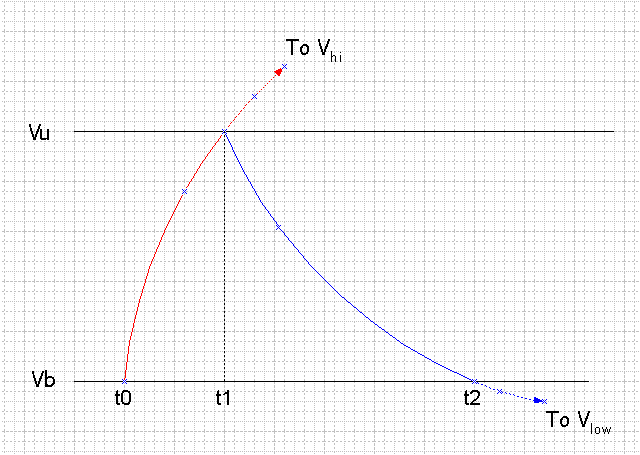

This is one of my oscillator circuits, that I am trying to develop a simple formula to calculate RC for Oscillation Frequency, based on the fact the oscillation is done with the Capacitor charge changing from 1.1V to 1.68V back and forth, for a set of physical numbers.
What I know so forth?
Having:
  • +5V power supply.
  • 100nF Capacitor.
  • Capacitor lead (a) is connected to Ground
  • Capacitor lead (b) is connected to a 10kΩ (1%) Resistor.
  • Resistor other lead is connected to the output of a 74HCT14 Schmitt-Trigger gate.
  • This auto-oscillating gate delivers +5V or Ground to the Resistor, so it charges or discharges the Capacitor via the Resistor.
Measured using Tektronix 2246 oscilloscope:
I don't know the time required for the Capacitor first charge from zero to 1.1V, this happens at Power On, and I don't care, but I know the Capacitor charges from 1.1V to 1.68V in 160μs, with +5V applied to the Resistor, then the Resistor is switched to Ground and the Capacitor discharges back to 1.1V after 413μs, when Resistor is again switched to +5V, and the cycle repeats forever, generating a sawtooth wave of 1745Hz.​

0.58 / 3.9 = 1 - [e^(-t/RC]
1 - 0.1487 = e^(-t/RC)
-t/RC = Ln(0.8512)
-0.00016 / RC = -0.1610
RC = 0.00016 / 0.1610 = 0.0009937
R = 0.0009937 / 0.0000001 = 9937Ω​

0.58 / 1.68 = 1 - [e^(-t/RC]
1 - 0.3452 = e^(-t/RC)
-t/RC = Ln(0.6548)
-t = -0.4234 * RC
RC = -0.000413 / -0.4234
RC = 0.0009754
R = 0.0009754 / 0.0000001
R = 9754 Ω​

The formula f = 2∏/ RC*3.58 = 1.755/RC, fits like a glove, and it has nothing to do with the voltages, charge and discharge times... perhaps I already grossly found it?
1.755 / 10k * 100nF = 1755 Hz, I got 1745 on scope
1.755 / 2k * 100nF = 8770 Hz, I got 8790 on scope
Found out 2kΩ resistor is in real 1976Ω, 10kΩ is 10060Ω, what somehow justify the such differences on scope.
Is there any rational and logical way to get to this simple f = 1.755/RC ?
Any help will be very much appreciated.

Hi Regis Tro, Welcome to PF.
You've already done most of the math required to find a simplified expression for the frequency. For a given cycle of the waveform you've found the time to charge (call it Δt1) and the time to discharge (call it Δt2). The period of a cycle is then T = Δt1 + Δt2. Frequency is f = 1/T.
If you assign variable names to all your constants and carry them through the calculations symbolically, you should be able to arrive at an expression for T that involves all the parameters. The time constant ##\tau## should be easily extracted from this leaving an expression that, with the given real-life values of the other parameters, should yield your desired multiplier for your period and frequency expression.
You might want to represent the IC's actual upper and lower output voltages as variables, since not every IC will "hit the rails" with its output.
EDIT: PS: You might want to examine the data sheet for your 74HCT14 Schmitt-Trigger. They provide a simple RC oscillator configuration and a suggested formula for determining the frequency :wink:
