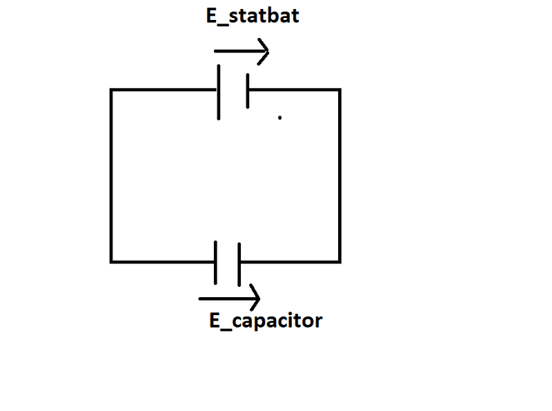

Hold on I make a figure I have in mind with a simple circuit with a resistor capacitor and a battery. Do you know some free available software that I could use or I ll just do it using Windows Paint !??
EDIT:
As you can see the E-field inside the capacitor and the electrostatic E-field inside the battery are in the same trend and direction...
I think what confuses you is that the E-stat field inside the battery opposes the current flow, while the E_capacitor is in the same trend with current flow, however both of those fields have the same direction and trend.

Delta² said:
View attachment 228756 Hold on I make a figure I have in mind with a simple circuit with a resistor capacitor and a battery. Do you know some free available software that I could use or I ll just do it using Windows Paint !??
No they're not; they are in opposition to each other. But if the E field in the battery is meant to be the electrostatic field you have just agreed with me since your two E fields do oppose each other and the circulation is zero.
I thought you said you agreed that the net E field in the battery is zero - what happened? Fact is that the emf E field in the battery points - to +, giving zero net E field in the battery since net E field = Estatic + Eemf, added algebraically.
If we take as positive direction of the loop the counter clock wise direction, then E_statbat can be taken as negative while E_capacitor as positive when calculating the ##\int Edl## around the loop. I don't know if that's what you mean when you say they oppose each other...
But if we view them purely as vectors, it is clear that E_statbat and E_capacitor have same direction and trend...
That is exactly what I mean.
It is not clear at all.
don't understand how you can say its not clear at all, if you view the two vectors just as I draw them in the image and forget for the moment that we talk about currents, emfs, electric circuits, just view purely the two vectors, what can you say?
OK, you are the battery, a swimmer swimming in the direction of your battery E field in a fast-moving river. The fast-moving current is in the direction of the capacitor E field. Are you swimming in the direction ("trend") of the current or against it?
Well, the current (officially speaking the current density) changes direction and trend through out the loop. Inside the battery the current has opposite trend than (the hypothetical current or displacement current) inside the capacitor. BUT that's one of the reasons current , officially speaking , is not a vector quantity in physics therefore it doesn't have direction and trend, current density has direction and trend.
I think all this boils down to the fact that when you say "oppose" or "in same direction" you refer with the relation to what happens to the current flow (or how we evaluate the ##\int Edl##) , while I refer to the definitions of direction and trend viewing them purely as vectors. So for you the two fields in the image are opposite because the field inside the battery opposes current flow, while the field inside the capacitor is at the same trend with current flow.

rude man said:
OK, purely as vectors, using conventional polar coordinates (r,θ) assuming the path is circular:
Eemf = +Eemf θ (counter-clockwise)
Estatbatt = -Estatbatt θ (clockwise)
Ecap = +Ecap θ (counter-clockwise)
Vectors are in bold. θ is the unit vector in the +θ direction (counter-clockwise).
Estatbatt and Ecap have opposite signs! They point in opposite directions!
Interesting you switch the problem to circular path and polar coordinates, when it is obvious that for rectangular path and cartesian coordinate the vectors have same direction.
I think your second equation is wrong or at least incomplete i would say cause the unit vectors in polar coordinate systems are variable vectors. Both ##\vec{r}## and ##\vec{\theta}## depend on the polar coordinates ##(r,\theta)##. If we assume the emf source to be at ##(1,\frac{\pi}{2})## and the capacitor at ##(1,\frac{3\pi}{2})## then it is ##\vec{\theta}(1,\frac{\pi}{2})=-\vec{\theta}(1,\frac{3\pi}{2})##
