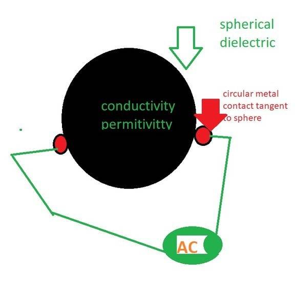

The two metal plates are circular, parallel and in 3Dimentions are located on the surface of a sphere, the metal plates are connected to AC source but low frequency.
we assume the sphere is solid and is made of a (dielectric)material with conductivity and permittivity (sigma, epsilon). So, now the Electric field is constant in all the points in between and out of the plates?

Okay, for a spherical linear dielectric the electric potential will be composed of Legendre polynomials. Do you know the general solution to the Laplace equation in spherical coordinates?

Maybe I misunderstood the description of the set-up. Does it look like this
or like this
Likes Artyman

I wanted to calculate the E-field at each point in the sphere. The two contacts on the surface of the sphere ( tangent to it).
I think you can use the potential of two opposite point charges to begin. The issue will be finding the potential which meets the boundary conditions at the surface of the dielectric sphere. To do this, you could use the method of images.
I should mention that without a strong math background this problem will be very intractable.

For boundary condition can you guide me which factors do I have to consider?
If we call the electric field inside the sphere ##\mathbf{E}_{in}## and the electric field outside ##\mathbf{E}_{out}## then at the surface of the sphere the following must hold:
$$(\epsilon_{0}\mathbf{E}_{out}-\epsilon\mathbf{E}_{in})\cdot\hat{r}=0$$
$$(\mathbf{E}_{out}-\mathbf{E}_{in})\times\hat{r}=0$$

Thank you. So, the only difference is not the dielectric constant in two mediums? the directions of the electric filed will be spherical and pointing the r. Am I right?
No, there can be nonzero components perpendicular to ##\hat{r}## which satisfy both equations. For this problem the field will have more than just ##\hat{r}## dependence.
