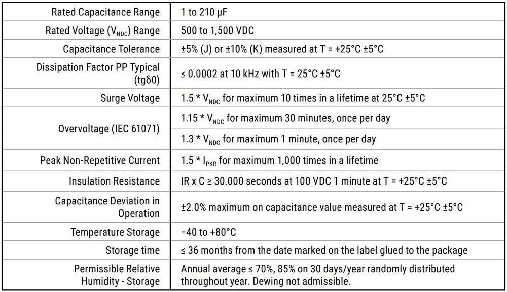

Hi,
I am trying to find the insulation resistance of a specific capacitor. I've posted on balancing resistors before and got some pretty helpful information. The previous datasheet gave the information in a different manner though. I'm hoping someone can help me decipher the insulation resistance from this datasheet.
The insulation resistance is given on page 4 as IRxC >= 30.000 seconds at 100 VDC 1 minute @T=+25 C
I don't know I or R and only know C (52.5 uF). Also, would that be read as thirty thousand seconds, or is it 30 seconds? I'm leaning toward 30 thousand seconds but the "period" instead of "comma" is throwing me off.
https://www.mouser.com/datasheet/2/212/1/KEM_F3114_C4AQ-1628369.pdf

willDavidson said:
Summary:: I'm not sure how to read insulation resistance from this datasheet.
Can you post a link to the full datasheet? That would be helpful.
And spaces are important...
IR (insulation resistance) x (multiplied by) C (capacitance in Farads) >= 30 seconds
I initially had no idea what IRxC was, and TBH, I still have no idea what the 1 minute test condition means (is that maybe the charge time?). At least R x C has units of time (one RC time constant), so that sort of makes sense.
And for electrolytic capacitors, I'm not sure the "insulation resistance" of the dielectric is linear with applied voltage. I generally look for the Leakage Current spec instead -- how are you wanting to use the "insulation resistance" or "leakage current" specs in your design? Knowing how you want to use them would help us to point you to the right things to look at in the datasheet.
Finally, things like capacitance and leakage current change over time and with temperature for electrolytic capacitors. Do you need to incorporate those changes into your design? (Like do you want your circuit to work within spec for the next 5 years? 10 years? etc.)

Sorry about that. I posted the link in the original post but didn't mention that's what it was. I'll post it below again. I just posted the screenshot to make it easier in case that's all that was needed.
These are actually film capacitors. I looked for a leakage current spec or graph and found nothing. It seems like 100,000 hrs is what these are typically rated for so I was assuming that if I kept it below 70 C and below the rated voltage that I should meet at least that lifetime (theoretically).
willDavidson said:
Thanks, that helps. First, it shows that "." is the decimal point and "," is the comma throughout the datasheet. But I still have no clue what they are referring to as Insulation Resistance IR. I haven't been able to find a description of the test that they are referring to, and there is only one non-descriptive reference to Leakage Current in the datasheet. Maybe try doing a more general Google search for IR Insulation Resistance of Capacitors?

Thansk, I read the full document. That helps to answer the question, sort of, I guess. Based on that, (IR) = 30s/C so for a 40 uF capacitor IR >= 750 kOhm @100 V. To me it seems like that's missing a lot of information. Am I wrong in thinking that realistically I should have at least a plot showing leakage current (LC) vs voltage (V) at a certain temperature? Ideally, I would also have one that showed LC vs temperature, but the other at the very minimum. I guess knowing 750 kOhm minimum @100 V is better than nothing...

I, and the manufacturer TDK, agree with @Baluncore that '30.000' should be read as '30 000'.
See pg.11 of:
https://www.tdk-electronics.tdk.com/inf/20/20/db/fc_2009/X2_B32921_928.pdf
Based on that, if you charge a sample in the morning it should self-discharge to 37% of voltage at the end of your work shift (8.33Hrs)! (but you better make sure the case is clean, the atmosphere is dry, and the leads don't touch anything! :eek:)
