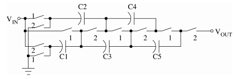

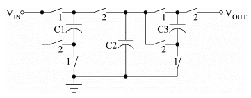

Here are two simple schematic of switched capacitor circuits. Basically, the capacitors are connected in different series/parallel configurations to transfer charge from one capacitor to the next and create a higher voltage on the output (most of the time). During steady state, the capacitors are under a DC voltage except during switching transitions. During switching transitions going between series/parallel configurations, the voltages jumps from one voltage to another. I am wondering if there are any special considerations for these capacitors that are subject to this PWM-like excitation.
As I see it, there is no reverse bias or AC component on the capacitors.
If a drive failure or load fault could reverse bias a capacitor, then a parallel diode would prevent polarised capacitor damage.
Capacitor ESR need only be slightly less than the commutator switch resistance.
Yes, the capacitors will not be reverse biased or have AC. I will be using film so that shouldn't be a problem anyway, I was really just hoping to find out if there were more things I should consider in a switched capacitor circuit due to the high dv/dt.
Why does the ESR only need to be slightly less than the commutator switch resistance? Of course lower will mean less losses but is there a reason just slightly less than the switch should be a maximum criteria for ESR?
You do not want the ESR of the capacitor to dominate the power loss.
Buying lower ESR capacitors will not make a big difference to performance.

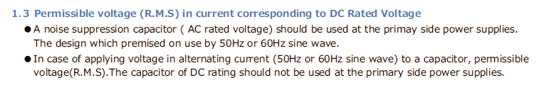

I guess the maximum voltage is rated for DC on these. The high dv/dt and PWM-like excitation is part of what led me to question if they should also be derated due to that use. Maybe it would fail in 80,000 hrs instead of 100,000, which isn't a big deal, I was just hoping to find out the nitty gritty of how they would be affected in general from this excitation.
The first datasheet you linked to explains the limitation starting on page 9.
https://b2b-api.panasonic.eu/file_stream/pids/fileversion/998
The underlying reason is the internal hot-spot temperature of the capacitor. This is determined by the current flowing thru it. And of course the current is determined by the frequency, applied voltage, source impedance of the supply voltage, and ambient temperature. Much of that calculation can be simplified to the capacitor current.
The example given in the datasheet on pg. 9 paragraph 1.4 assumes a low impedance source and bases the the voltage limit on rated current and capacitor reactance. The example calculation picks a 40kHz frequency and a current of 2Amp. Current limitations are in the graphs an pg.10. From all this, it shows a maximum of 53V RMS applied to the capacitor to keep the current, and resulting temperature, within operating range.
The equivalent calculation for pulsed operation follows the above on pg.10.
