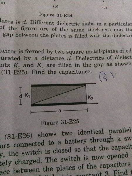

A capacitor has square plates of length a separated at a distance d. Dielectrics are inserted as shown in the figure. Find the capacitance
[/B]
I know that I have to integrate, but can't get an expression

What would be the capacitance with 100% of material 1? With 50% of material 1 (and 100% of material 2)? With a fraction x of material 1?
What would be the capacitance if half of the length had x% of material 1 and the other half had y%?

Take an element dx at a distance x from any end for this caculate dc
You can form an elemental area dx dy on the bottom plate, extend the area along the z axis
as a column to the top plate, compute the capacitance of this column as the series connection of two capacitors, then add (integrate) the parallel columns to find the total capacitance.
Actually, it is easier to form dx columns of equal dielectric distribution, then there is only one integral to evaluate.
Yes, that is how I solved it.
Likes rude man
Okay I got
dc = εa^2k1k2dx ÷(d (xk1 -xk2+k2a) and after integration c
C = εa^2k1k2ln(k1÷k2)÷(d(k1-k2)
Likes rude man
You're a bit sloppy with your parentheses, but the result looks good if you make those corrections, replace your ε with ε0 and wind up with C = {ε0κ1κ2a2/D(κ12)} ln(κ1/κ2).
Note that I changed distance from d to D to avoid confusion with the calculus.
It's obvious you went the right way, good going.
carlyn medona said:
Okay I got
As rude man said, replace ε with ε0.
Just for fun, see what happens when you put k1=k2 in that equation.
Likes rude man
Good one, cnh! I wondered about that myself, thought at first I had made an error, finally determined the limit existed and agreed with the degenerate case k1=k2=k.
Likes cnh1995
