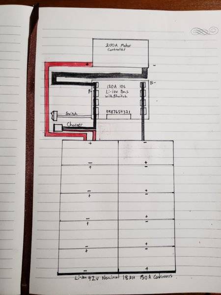

So I'm interested in adding a bank of capacitors to help reduce the initial load on my batteries when accelerating from a stop but my current set up uses regenerative braking. My electrinics are this order, Motors, VESC, BMS, 10s5p Li-ion pack. If I add capacitors between the bms and vesc to supply the initial burst of energy needed for take off would regenerative breaking cause an over charging issue if let's say braking down a long hill? Or would the extra power flow back to the battery once the caps are full? Just trying to understand a little more, thanks for any help.

Can you post a schematic of your system? It sounds like it should be okay, but there are some potential issues that it would be good to check. Also post links to the datasheets for all of the components please (batteries, caps, motors, etc.). Thanks.
The motors are 2x 170kv 65amp each, the Vesc (motor controller) is a 200amp 10s. The bms is a 120amp continuous discharge, and the battery is an 18ah and capable of 150amp continuous discharge. I don't need or want my motors maxed out so I chose 50amps each bringing my total power required to 100amps continuous at any given time. I chose components that gave me head room for thermal efficiency and redundancy. Have I reached maximum efficiency because my battery can push 150a and I'm only asking for 100a? Would adding caps help reduce strain on the battery? I've ran out of room to add any more batteries so I was wondering if a few good caps could help.
Also I don't have a good way of providing a schematic. But I'll work on it.
If you can find a PDF or JPEG file, use the UPLOAD button in the lower right of the Edit window to attach a file. Otherwise, you can post a link to the documents if you have a URL. :smile:

Lots of great info everyone. I'm blown away by the responses and the amount of information.
My max amp draw is capped to 100A in the programming of the motor controller So there shouldn't be any bursts going on. I'm 155lbs. I was interested in adding super or regular caps because I do a lot of stop and starts on the route I'll be taking. Here is a super rough sketch of my set up. I would be adding a bank of caps inline with the leads going to the motor controller from the bmsP- and battery+. I have heard of people doing this but wasn't to sure how it works exactly or if it would be of any benefit even though my battery is theoretically capable of 150a sustained.

Without some serious experimenting and measuring, you cannot tell just what the arrangement is achieving. Without thinking too deeply about it, I would worry about any long term harm that the capacitors could be doing to the batteries. Lions need to be charged right.

Paralleling capacitors to a battery for short bursts would make sense if the battery source impedance is "slow" vs your application or you have very large inrush currents that might damage them (eg the starter batteries in the links above), but you would have to measure how much the volt dip is during said pulse at the inverter terminals to determine if this has any value. Keep in mind that any motor drive is already going to have some pretty high quality capacitors on its internal DC bus to deliver the xkHz PWM current and keep that HF current local to the inverter. Basically for transient current its an impedance matching game and the capacitors would have to approach the source impedance of the batteries for them to have any worth while effect.
To me the OP is not pushing his batteries (rated 150A and only pulling 100A) and unless the voltage dip is significant at the inverter terminals a capacitor would likely have minimal effect for transients and would need to be huge to provide noticeable energy storage increase.
IMO determine if there is even a problem with the set up as is by measuring before adding more stuff to it, if its a hobby and you just want to have the caps then fine but in any sort of product development there'd have to be a pretty compelling case to add them to warrant the cost.
Likes RedBaron
