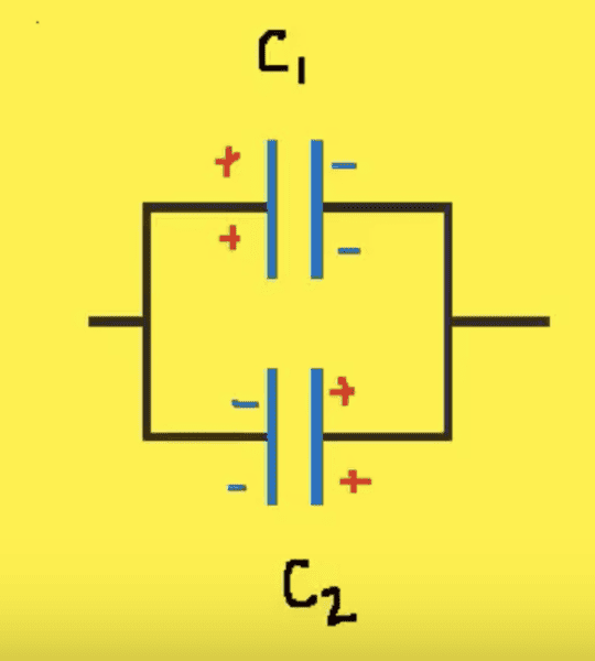

Capacitors C1 = 6.97 uF and C2 = 1.54 uF are charged as a parallel combination across a 281 V battery. The capacitors are disconnected from the battery and from each other. They are then connected positive plate to negative plate and negative plate to positive plate.
A) Calculate the resulting charge on capacitor C1.
B) Calculate the resulting charge on capacitor C2.
from this answer
http://www.chegg.com/homework-help/questions-and-answers/capacitors-c1-697-uf-c2-154-uf-charged-parallel-combination-across-281-v-battery-capacitor-q1385340
Q = CΔV
So q1 = 1.5x10-3c and q2 = 5x10-4c. Why would the drawing show opposite polarizations on the plates? Shouldn't the battery give the same potential drop across two capacitors in parallel?
Because,
But the picture is as they are charged and before they are connected positive to negative and vice-versa I thought?
No. It is just after they are reconnected in series.
That would be true when the capacitors were charging.
