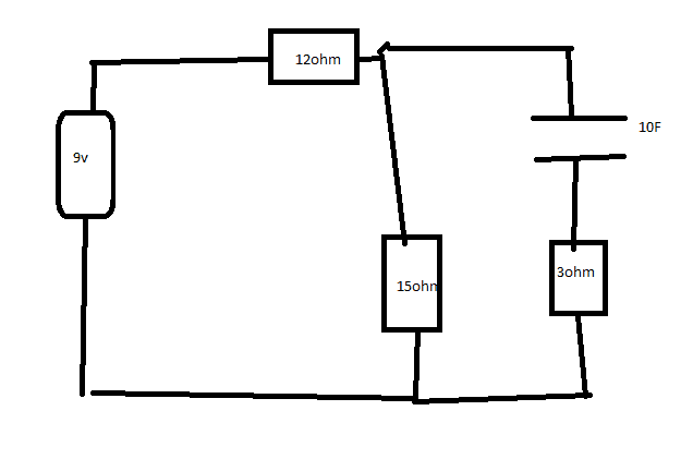

Find energy stored in capacitor after switch has been closed for long time.
Hi there,
So as far as I know, after long time, current doesn't flow through the resistor That means the voltage drop across the capacitor is equal to the EMF of the cell = 9V
So will the charge be ##U = 0.5CV^2## = ##0.5(10)(81)##?
Answer appears to be wrong, not sure what I am doing wrong here.

through what resistor? I think after a long time there won't be any current through the capacitor, and therefore no current through the 3 ohm resistor.
I can really see no reason for that, no matter which resistor you meant.
If there's no current through the capacitor, you can remove it from the circuit, solve the remaining circuit to find the voltage across the capacitor.

Won't the voltage across the capacitor be 9v?
Isn't the 15Ω resistor connected too? Think about its effect.

Ah..Solved it :) ##1.25x10^{-4}##
