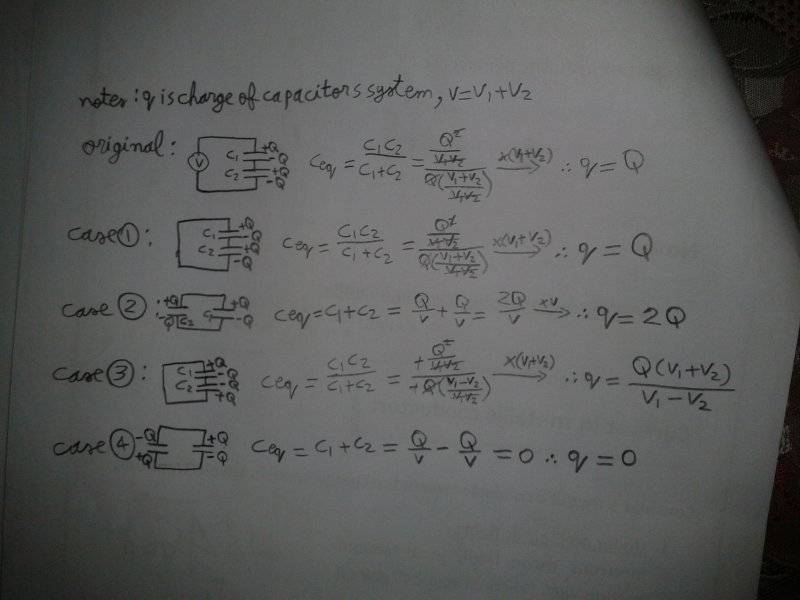

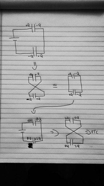

suppose 2 capacitors C1, C2 connected in series with battery V, let charge in circuit be Q, since they are connected in series so each capacitor will have Q also, suppose we disconnected them from the battery and reconnected them again in series (without connecting voltage source or Earth with them), as total Q in capacitors in the old connection is 2Q so this is the charge in the new connection, and since the new connection is also in series so each capacitor will have 2Q (double the charge in the old connection), is this right ? and if not right, what's exactly the wrong thing in what i have written ?
No, that's incorrect. As a general rule, the charges in a circuit are a "zero-sum" entity. Electrons aren't inserted somewhere, they are always just moved around from one spot to another. When you disconnect the battery, yes, the plates will be charged with a certain Q, but the plate of the second capacitor that was connected to the other terminal of the battery has a charge of -Q. When you just connect the two terminals (without the battery inbetween), the Q and -Q will equalize again (probably with a nice spark), and you have zero Q everywhere again.

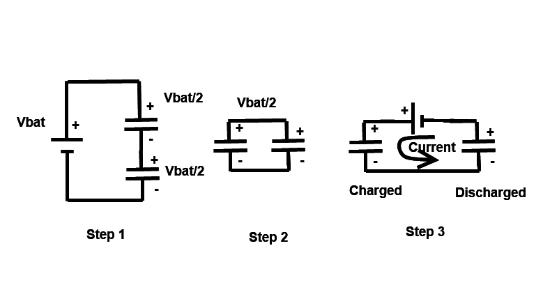

That can only happen if the sequence as per this diagram. Note one capacitor is discharged in step 3. If that's not the sequence you mean please post your own version of the drawing..
I don't agree with that sequence. At what point, and why, should that capacitor on the right discharge?
Oops There is an error on that drawing. Step 2 the voltage should be vbat/2 not vbat.

Because the current flow will be anti clockwise.

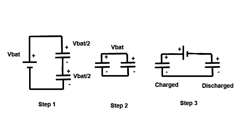

Updated drawing...
Whichever way around the battery is inserted one of the caps will be discharged.
But, how could one cap be charged and the other completely discharged when they are connected by the bottom wire?

Nah, I think I'm still correct. I think the problem is that you are conflating potentials with charges in your drawing.
The next iteration would give a 3Q and -1Q combo, then 4Q and -2Q, etc.
Mohamed, can you produce a more cleaned up version? It probably makes sense to you, but for an outsider its virtually indecipherable. All I see are wild formulas everywhere.
Case 1 is definitely wrong, as that configuration would discharge itself immediately. So is case 3.
Also, how do you arrive at two different results for the same configuration?
rumborak said:
#2 is definitely wrong, as that configuration would discharge itself immediately.
you mean second capacitor or case 2 ??
Sorry, I edited my post. I meant "Case 1". That configuration is a short circuit of two charged capacitors.
But my other question is: How can case 3 be the same configuration, but you get a different result?
concerning case 1 : do you mean that the battery is necessary for the system to make its charge Q ?
concerning case 3 : exchanged the plates of one capacitor of them and made it negative with respect to the other capacitor
Sorry, had not noticed the reversal of charges in case 3. But still, case 1 you can't really calculate like that. The formulas you are using presume ideal components; at the moment of your case 1 picture, you are short-circuiting ideal components. Meaning you have infinite current, and an unaccounted-for potential difference between the capacitors.
  • #31
re post #23 (Bottom left corner of the diagram)
The bottom capacitor goes from +Q, -Q to 0Q, +2Q. So the voltage polarity has reversed. That certainly looks like it's been discharged and recharged in the opposite direction :-)
A change from -Q to +2Q implies a current of 3Q flowed. Yet other nodes change from +Q to +2Q which is only an increase of Q. How is that possible if they are in series?

mmm, but i think all that in the paper doesn't hold unless c1 = c2, the final answers wouldn't change but the steps would change, for example in case 2 if c1 not equal c2 therefore Q1 will not be equal to Q2 but there summation still will be 2Q

@CWatters, crap, you are correct, the picture is incorrect. The two right plates should read -2Q (top) and 0Q (bottom). Which would mean, when you cross them over, you are connecting a 2Q to -2Q. The reversal of polarity is what kills it in the end.
It was a nice idea, lol.
EDIT: Thinking about it more, there's also the argument that charges are a zero-sum game. If I create a 2Q somewhere, somewhere else must be -2Q. The only way of reconnecting it without massive discharge would be to find another 2Q potential. Which really could only come from another device.
Hmmmmm, got to think more about this.

so i think case one would only be short circuit when c1=c2 :D , but if c1 not equal c2 so voltage will be distributed not equally between them (because in series) so i think it will not be shorted
