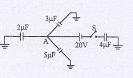

Three capacitors of 2μF, 3μF and 5μF are independently charged with batteries of emf's 5V, 20V and 10V respectively. After disconnecting from voltage sources, these capacitors are connected as shown in figure with their positive polarity connected to A and negative polarity earthed. Now a battery of 20V and an uncharged capacitor of 4μF capacitance are connected to junction A as shown with a switch S. When switch is closed, find:
a)the potential of the junction A.
b)final charges on all four capacitors.
(Attachment 1)
Honestly, I have no clue what happens to the initial charges of capacitors when the switch is closed. I tried to solve the problem as if there are no charges on capacitors initially. Attachment 2 shows the simplified circuit I made. I found the potential at A and got 40/7 V which is incorrect, so I think there is some role of the initial charges which I am unable to figure out. :(
Any help is appreciated. Thanks!

Let's display those circuits as images.
How much charge is on each capacitor immediately after charging?
Once the three capacitors are connected, they are in parallel with with their positive plates connected by conductors. What is the total charge on their positive plates?
Likes 1 person

The charges on 2μF, 3μF and 5μF are 10μC, 60μC and 50μC respectively.
The total charge is 120μC but I don't see how calculating the charges helps. :confused:
You can determine the potential before closing the switch from that 120 μC.
What happens when the switch is closed? What happens in a very short time after closing the switch? Does the charge stay on the parallel connected capacitors? ehild

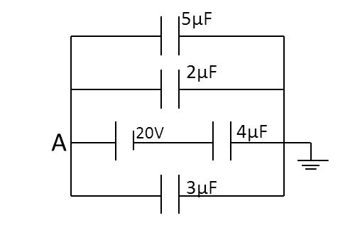

The three capacitors are connected in parallel, and you know the charge of the resultant capacitor, so you can determine the voltage. But the problem does not ask that.
Yes, the charge on the parallel connected capacitors won't stay there. The circuit is grounded, and there is the battery with fixed emf. The charge can flow through the battery and into or out of the Earth .

With switch S open, the charges on three capacitors would rearrange because the three capacitors are at a different potential from each other.
Of course, the charges of the three connected capacitors rearrange, so the potential difference is equal across all of them. You can treat them as a single capacitor, with charge Q=120μC. Now you connect a battery and a 4 μF capacitor across. What will be the potential of A?
You should note that charge can flow through the battery, but can not accumulate in it. So the sum of charges on the left plates of the capacitors is equal to Q=120 μC, x on the lower capacitor and Q-x on the upper one. The right plates will be negatively charged, as the ground provides charge.
Between the ground and point A, the potential changes by equal amount both across the upper capacitor and along the lower branch of the circuit.

The potential change in the lower branch is: ##20-x/4##.
The potential change in the upper branch is: ##(Q-x)/10##.
Equating them doesn't give me the correct answer. :(
If I write the potential change in the lower branch as ##20+x/4## and equate, I do get the right answer. :confused:
Is this because we assume x to be positive (though it turns out to be negative)?
Also, I don't get why did we solve it this way. Why is it wrong to simply solve it as if there were no charges initially? What would I do if the circuit was not grounded? :confused:

Why do you write 20-x/4? Supposing the left plates of capacitors have the charge and the right plates have the opposite charge, UA=x/4+20, UA=(Q-x)/10.
x happens to be negative - it does not change anything.
The "usual" solution assumes series connection of the capacitors, with equal charges on them which is not true in this case. The initially given charge can not disappear, it only can be distributed between the connected plates.

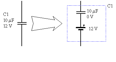

I don't know if it will help you at this stage of the game, but note that for analysis purposes an initially charged capacitor can be represented by a model consisting of an uncharged capacitor of the same size in series with a voltage supply with a potential difference equal in value to the initial potential across the capacitor.
You can then use all the usual circuit rules to combine sources, etc., to simplify the circuit and determine any change in charge that will occur on the capacitor.

For the non-earthing case you can also apply Gneill's method to find the final charge of the 4 uF capacitor, assuming zero initial charges, but an extra battery.
Oh yes, I do get the same answer. Thanks gneill and ehild! :smile:
