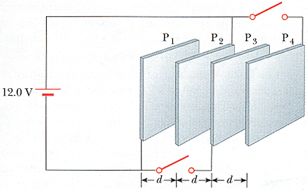

Four parallel metal plates P1, P2, P3, and P4, each of area 7.50 cm2, are separated successively by a distance d = 1.06 mm, as shown in the figure below. P1 is connected to the negative terminal of a battery, and P2 to the positive terminal. The battery maintains a potential difference of 12.0 V.
Important: http://www.webassign.net/pse/p26-55.gif
(a) If P3 is connected to the negative terminal, what is the capacitance of the three-plate system P1P2P3?
(b) What is the charge on P2?
(c) If P4 is now connected to the positive terminal of the battery, what is the capacitance of the four plate system P1P2P3P4?
(d) What is the charge on P4?
C=A/D
I tried drawing the circuit in a simple way, i had no idea, i tried it once using parallel (P1P2, P2P3) and failed, i tried it in series, also p1p2 and p2p3... it is wrong... i have no idea how the circuit looks like, i have no clue how to solve it, and it is due in less than 3 hours :P ... any tip would be appreciated
Hint: Any two plate surfaces that face each other constitutes a capacitor. This means that a metal plate between two others represents two capacitor plates, one for each of its surfaces (think of the surfaces themselves representing the plates, and the bulk of the metal in between them as just a conductor joining them). Thus one metal plate can in fact be part of two separate capacitors.

I drew it where p1p2 are parallel to p3p2, and here are my full results (all wrong):
125.295 pF
1503.54 pC

Well, P1P2 are in parallel to P2P3. So that's okay. But your result is out by an order of magnitude. Perhaps your unit conversions went astray?
What value you did you get for the basic capacitor consisting of two plates with the given separation?
epsilon0 * A/D
around 6.2647555 E-10

Seems to be off by a factor of 100 (it's too large by that amount). You'll have to spell out the whole calculation, constant and all.
Epsilon Node: 8.85...E-12
A = 0.075 M
D = 0.00106 M
it would be ironic if my mistakes are from cm -> m and mm-> :P ... because i used google to do that

Your area is off. Probably because it's not a conversion of cm to m, but cm2 to m2.
oh.. ok, fixed :P ... damn, stupid mistakes... THank you soo much
