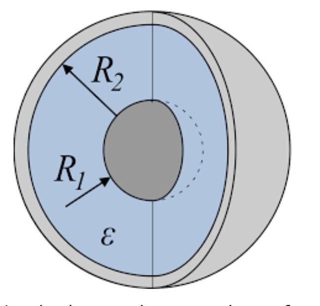

A spherical capacitor consists of a hollow or a solid spherical conductor surrounded by another concentric hollow spherical conductor.
$$C= \dfrac {4\pi\epsilon R_1R_2} {R_2-R_1}$$
Likes hutchphd and Delta2
OK then its explicitly localized and for usual low frequency work is just a capacitor as discussed.
