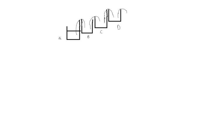

Please look at the picture.I wanted to ask if water from A will go to B then to C and so on..

Andy Resnick said:
Are you asking me, or the OP? In general, wetting is not accompanied by a change in temperature, although thermal gradients can change wetting behavior.
Yes, I was asking you, because, if the system is going to a lower PE state then Energy is conserved so is it reasonable to suggest that it would appear as a rise in KE / temperature? This is not what I thought originally but seems to make more sense.
OR is the energy just rearranged in Potential form - Electric to Gravitational, with no change in KE? From what you say, this is probably the right way to see it.
In the context of capillary rise, the gain in energy caused by raising a volume of fluid is equal to the loss of energy due to wetting. In the absence of gravity, a fluid column will not stop rising- alternatively, a perfectly wetting fluid will spread until the entire substrate is covered (as long as the continuum approximation is valid).
Does that help?
So it's: Work In = Work Out (and not thermal).
Fair enough, thanks.
