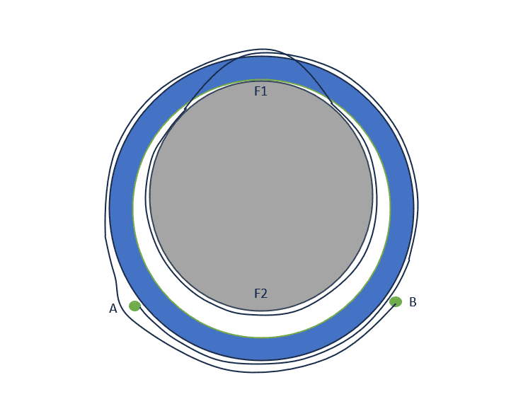

We have a following setup (see below). A plastic rod is placed inside a plastic ring. A wire is wrapped around a plastic rod from which it goes to the outer surface of the plastic ring. The friction coefficient between the wire and the plastic ring is about 0.1. We have several different sizes of plastic rods but the wire length always remains fixed. As such the endpoints of the wire change position according to plastic rod diameter (see second picture where points A and B have moved). In short, the smaller the diameter of plastic rod, the more we have wire in the outer ring.
We use the wire to pull the plastic rod against the inner surface of the ring. We measure the contact force F1 which is the force between the plastic rod and the inner surface of the ring. We would need to understand the relationship between F2 (the force between the wire and plastic rod) and F1 in different rod sizes.
I would assume that the friction between plastic ring and wire causes force to be lost due to capstan equation. That is, with smaller plastic rod we have more friction. As such I would assume that for given fixed force F1, the F2 varies according to the rod size? In other words we would achieve same force F1 with smaller F2 (and wire tension) with larger rods. :

I'm realizing I'd first try to solve it for the case with no friction. I'm not sure it's trivial. @Oseania have you solved that simplified version of the problem?

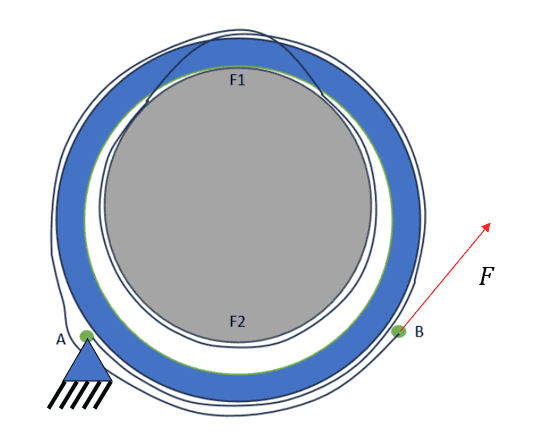

Are both points A and B attached to the ring, or is point A attached to a fixed object.
If A is fixed to the ground, then the wire forms a band brake which behaves like a directional clutch, that only allows rotation of the ring in one direction.

Where the wire slips off the ring, to pass around the rod, how come it does not continue to slip off the ring? If the rod was outside the ring, or guides were provided, that would not tend to happen.

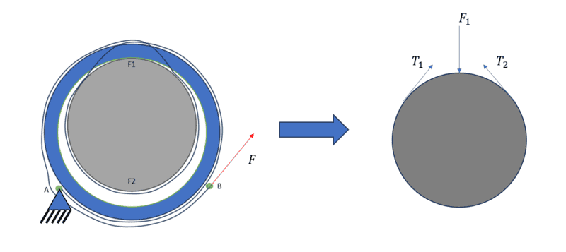

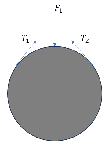

I'm not sure I understand what ##F_1## and ##F_2## are supposed to represent. To me, it looks like - if we do a free body diagram on the rod - they are two vertical forces, equal and opposite.
The capstan equation has to do with the tension in the wire and the forces at the end of that wire. I failed to see how this would change anything to the fact that ##F_2## is equal in magnitude to ##F_1##.

I think it'd look like this:
If there's no friction then the tension in the wire will be uniform and equal to the external force applied on it so ##F=T_1=T_2##. From the geometry of the problem it is possible to obtain the value of ##F_1##.
If there is friction, then ##T_1## and ##T_2## won't be equal due to Capstan friction. However, I'd assume that the tension on the wire will tend to equalize as time and vibrations go on. I guess the equivalent uniform load could be obtained and the value could be recalculated again.
For example, during loading you will be able to preload it up to a certain point but not all the wire will reach the same tension due to friction so you'll be limited by the point at maximum stress. As time goes on, I believe the tension will tend to equalize so you might loose effective preload. The exact values would depend on the geometry of the problem.
@Juanda's sketch in Post #6 nicely shows the free body diagram (FBD). In the absence of friction or torque on rod, the two forces ##T_1## and ##T_2## are equal. If you know the angle of ##T_1## and ##T_2## relative to ##F_1##, then ##F_1## can be calculated from ##T_1## and ##T_2##, which are equal and equal to the tension in the wire. If the angles change with different rod sizes, then the force will change.

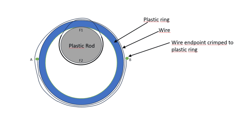

I understand that I might have oversimplified the problem a bit. Mechanically what happens in the device:
1. The plastic rod placed inside the wire (see figure 1).
2. The positions A and B are moved so that the wire is tight. Now, these positions depend on the rod diameter.
3. When wire is tight, we heat the wire (it is shape memory alloy) which causes it to shrink a bit. This further tightens the wire around the plastic rod. The wire slides so that the excess slack is taken out. Note; the positions A and B remains fixed in the ring body.
4. We measure the contact force F1.
We suspect that the for given contact force F1 (e.g. 10N) the other contact force F2 varies depending on the rod size. That is, it is not 10N but something else depending rod size. We suspect that this causes some issues in our setup.

Now, back to the problem at hand. Like @jack action said in #5, the forces ##F_1## and ##F_2## will be equal. They must be so the plastic rod is in equilibrium and that fact does not depend on the geometry of the ring and rod. That's assuming both forces are aligned by the way.
Also, ##F_2## will be the resultant force from the contact between the wire and the rod. It's more like a pressure and that's the resultant force from the pressure along the contact area. The same goes on with ##F_1## but that looks more like a "contact point" although it'll also deform creating a pressure area that has an equivalent force associated with it.
What I think you need is to find out how the tension of the wire is related to the forces ##F_1## and ##F_2##. That's what I was aiming at with what I posted on #6.
In that scenario, the geometry will affect the contact forces because different rods will cause different angles.
Since you have experimental results to compare with, I'd recommend you solve the contact force as a function of the tension in the wire and the diameter of the rod considering there is no friction at all. If the results differ significantly then it suggests that either you didn't solve the problem correctly or that friction is actually something you need to add to the model. If you have doubts, maybe you can use some lubricant to reduce friction and compare the experimental results with your model too, or check if lubrication changes the force ##F_1## you can experimentally measure.

This is an impossible topology.
Any tension in the wire, will pull the wire over the edge, and off the outside of the ring.

I can't see what you mean. OP said this is an actual experimental setup he's working on. How could it be impossible?
I'm imagining the "ring" more like a tube. It's true that if the "ring" is not long enough, the wire will just be impossible to tension as you said.
Maybe OP can share a picture of the real setup next to the diagram to clear the confusion or something similar.

No, it is not impossible topology. We cannot share images of the actual device but it is pretty much wrapping a wire around a plastic rod, and then attaching those wires to a "ring". Of course you need to have grooves in the ring to guide the wires etc. but they are not important to the forces and tensions.
We are now conducting new measurements which hopefully allows us to understand better how capstan friction plays part.

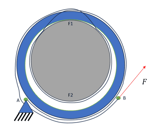

Now I started to think that as people have said the forces F1 and F2 have to be equal naturally. However, would the pressure distribution on the plastic rod depend on the rod diameter?
I'd say yes. The diameter will be related to the angles of ##T_1## and ##T_2## (look at post #6). It'll also change the amount of surface contacting the wire.
I maintain I would proceed as explained in #9. This is:
