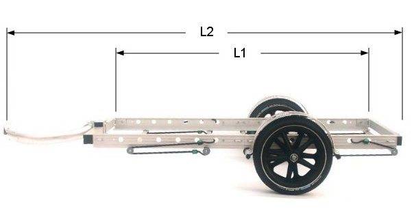

What sort of service life are you looking to achieve? I would look into the use of one of the Spectra ropes as opposed to steel cable. The Spectra or any of the other alternatives (all of the 12 strand single braid lines be it the red, the grey, or the blue just look for urethane coated single braid) are far lighter and much easier to attach and spool. They also are stronger then steel and more forgiving if misaligned or kinked. In either case the closer you can approach a balanced system as Baluncore noted the easier the system will be to power.
Best maybe to endure more trips by dropping the combined trailer weight and maximum required load to under 700 lbs by using this...
http://www.bikesatwork.com/bike-trailers/specifications
It's toughest configuration is rated for handling maximum 600 lbs of cargo and that particular trailer itself weighs just 70 lbs.
If we went that route, do you see any reason why this capstan winch http://portablewinch.com/en/products/PCH1000.html
rated at Max. pulling force 775 kg (1700 lb) and Rated lifting cap 250 kg (550 lb) couldn't readily handle worst 45 degree incline?
I'd just have to figure out a skid plate for it for whenever the tongue was on the ground. The tires can be placed more forward or
back and loads situated so that we could strive to keep tongue from excessively scraping. That'll take some experimentation. Also,
lowering it straight back down hill will probably be a challenge, but most any trailer we'd use probably would be, too.
What do you think?

Appreciate all the comments, at this point I'm really zeroing in on what I'd posted in my last, #7 above, posting.
I'd only add that I'm looking at Samson Stable Braid in 1/2” diameter, it's a double-braid, 100% polyester rigging
rope with "exceptionally low stretch" they say, and a breaking strength of 10,400 lbs. It's been used and praised
by other owners of same capstan winch specified above.
That reduced load and requirements on winch and rope and reduced cost of all components is attractive, if it'll
both work and with sufficient safety margin. My intention at this point is, with capstan winch anchored atop, I'd
draw up the cart. An available option, for little additional $, I'd likely do, too, is to get second set of axle/tires so
it's much less of an unstable rickshaw. And, while getting rig back down hill can be down in a very slow speed
controlled manner, steering could likely be an issue requiring trial & error experimenting with it.
As described in post #7 above, along with what I've also shared here, does this set-up look like it oughta do the
job and with a sufficient safety margin?
- Shane
