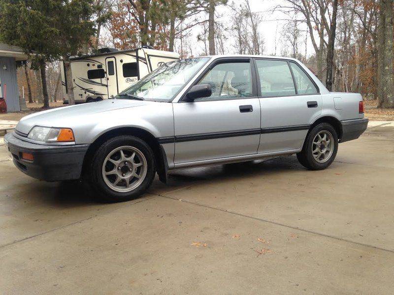

I have a FWD 1989 honda civic (I am 42 with three kids) and i se this car as my learning tool for fun, make it fast, make it stick. I track day auto x and road coarse and don't care if I ever win a trophy. (I always leave early). I also DD this car because it's fun to drive. This car is fast for a civic so my next step would be to add aero (no wing coments please, NO WING!) so I'm starting under the car but and here is my biggest but, I don't want to put it away in the wintrer and also I'm trying to achieve MAXIMUM down force from 40 to 100 with minimum drag and if the drag is too much then ill add some active aero to reduce drag.

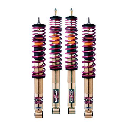

So, your saying no rake (but I am not slammed on the ground?) ok?? but I am trying to neutralize my center of downforce also and with a FWD all the weight is in front which means I don't want to be too aggressive up front, or do I?
you are not compressing anything. If you are referring to limiting air under the car, this is not compressing. The rate of flow on top of the wing must equal the rate of flow under the wing. This is why your car will have rear end LIFT at high speed. The length of the under side , front to rear is a lot less distance than the length of the hood, the front windshield , the rear wind shield and the trunk. So the air must travel a lot faster on top of the car to equal flow rate under the car. Without additional modification this will not happen and we have a lift condition crated under the car at high speeds. this you do not want..
ifin you want to learn how to make your sedan run ,, read Race Car Suspension class in this very forum.. i cover FWD cars in it

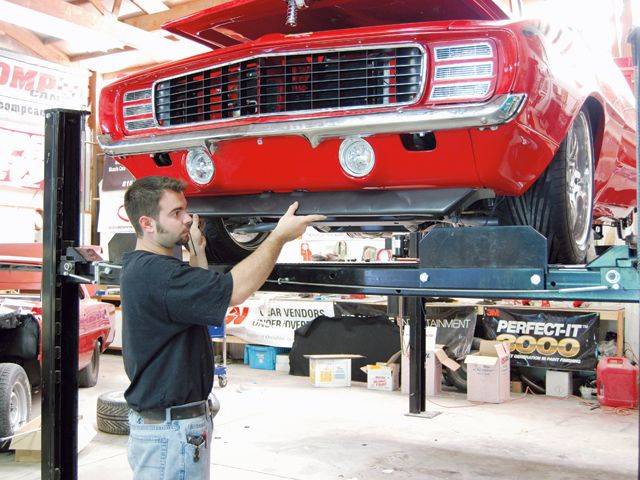

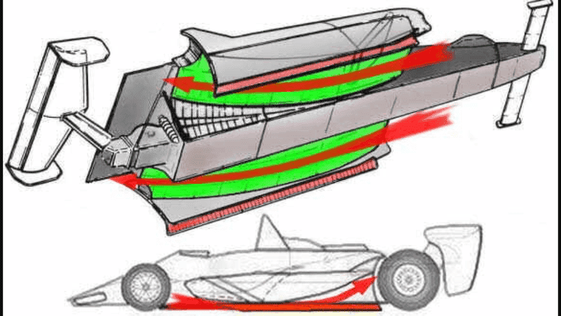

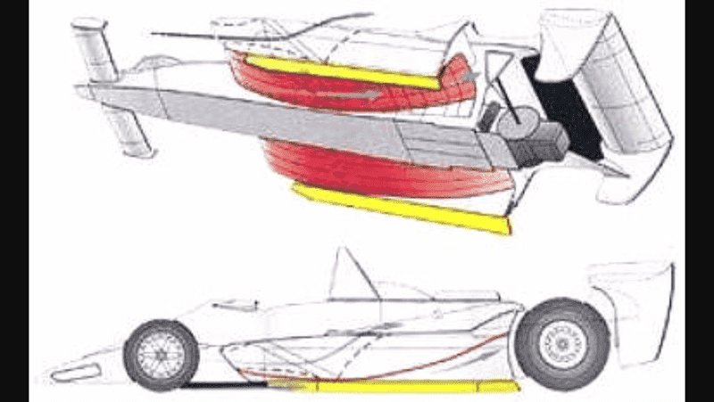

This is the direction I'm talking about. F1 knew by ramping the front of the tunnel you can increase the speed of air thus reducing air pressure = downforce. Is there any logic in this on a street car?
absolutely not.. for get it..you have at least 3 inch +/- suspension travel required for pot holes, speed bumps road conditions etc...no way can you seal up the front and sides to get any kind of aero on this door slammer..go for items i note in race car suspension class
The maximum amount of down force you'll generate with a Civic... especially trying to use ground effect is approximately zero.

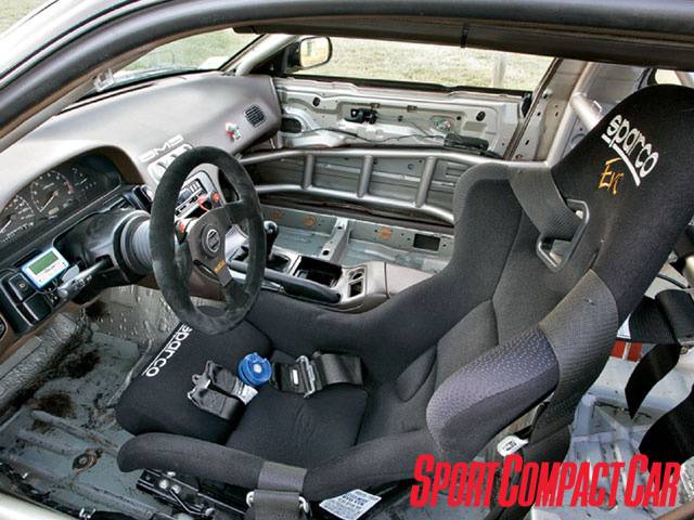

If you want to go fast in it do the following:
Make the interior look like this

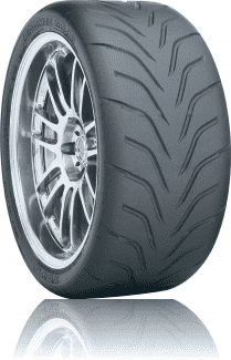

Add a good set of these:

The idea behind the 70's Formula car is to create a very large inverted wing. Being close to the ground, it create a tunnel effect that increases the effect of the wing. An important characteristic of the wing is that it has a center of pressure (CP) where all the aerodynamic forces act (the aerodynamic equivalent of a center of mass). Where you put that CP have a big effect on the front/rear load distribution. For such a big wing, you probably want a 50/50 distribution, so it is mostly centered relative to the car (the CP should be close to where it is the closest to the ground).
If you can't create that perfect wing shape (like with a sedan with an engine and other components in the way), then you must use another approach.

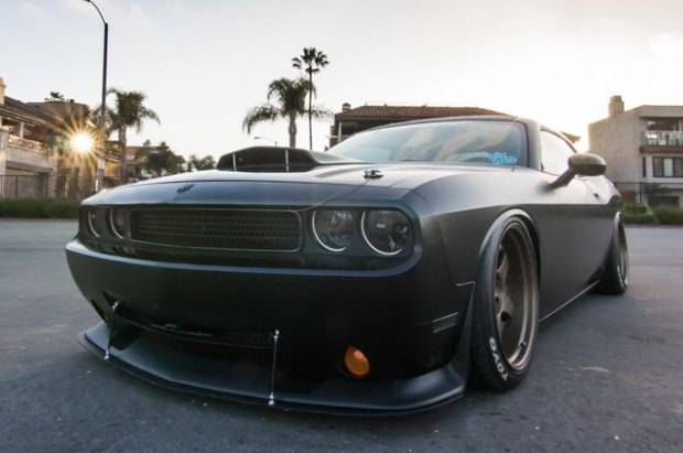

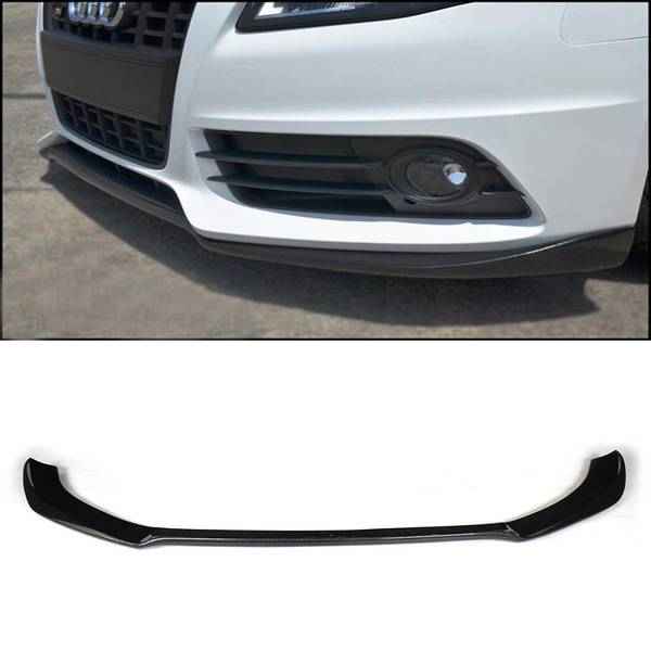

The other approach is to create a «vacuum» under the car. You do that by blocking the front and side entry with an air spoiler and side skirts. If you imagine a car moving one car length really fast, if the front and sides are perfectly sealed then the «block» of air under the car will stay still, going out the rear end, while no other air can enter beneath the car. No air = vacuum, i.e. the lowest pressure you can achieve.
Now, perfectly sealing the front and sides is impossible, but the less air that goes underneath the car, the lower the pressure you can achieve under it. Here are some examples of front spoilers that exist solely to block the flow from entering under the car:
