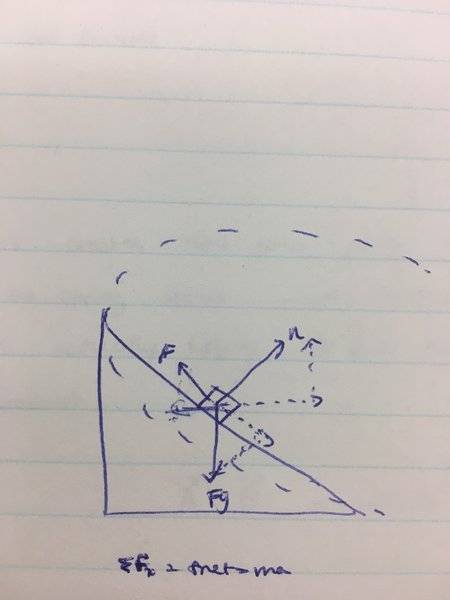

Does a car on a banked curve have a component of gravity that accounts for the centripetal force ( along with the normal force)?

No it isn't. This is what my FBD looks like:
That component of gravity has no affect to the center of the circle right? It's just opposing friction?

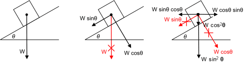

Left to right:
The weight vector.
The weight vector decomposed into components parallel and perpendicular to the incline.
Each of the two vectors in the previous diagram decomposed into horizontal and vertical components.
Yes, indeed, there are horizontal arrows in the third figure, but their sum is zero. I think it is inappropriate to pick and choose one of them and say that it contributes to the centripetal force whilst ignoring the other. Note that the sum of the vertical arrows gives the weight as expected. Also note that if the weight were a polarized electric field vector and the incline line were the axis of the polarizer, then in the second figure there would be no ##W \cos \theta## term. That would eliminate the horizontal component pointing to the right in the third figure, which is probably what you had in mind.

In the case of the frictionless banked curve, the contact force with the plane is normal to the plane and has a horizontal component that provides the centripetal acceleration while its vertical component keeps the mass in the horizontal circle. In other words, being a contact force it adjusts itself to provide the observed acceleration.

Yes, the normal force from the surface accounts for all the centripetal force. No need to look for additional contributions from gravity.

The equation for the centripetal force becomes
∑ Fx = mv2/r = Nsinθ
still no additional term for gravity needed. In effect it's already included in the normal force N.

The OP asked if a component of gravity contributes to the centripetal force in addition to the normal force. The answer to this is no because the effect of gravity is already included in the normal force.

kuruman was right earlier. You can resolve gravity into two components with one down the slope but you can't ignore the other one. If you could ignore one then it would be possible to prove gravity had a component that acted upwards.
