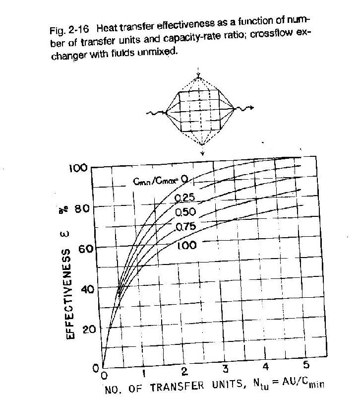

The book referenced in Post #5 has the following performance chart for a cross flow heat exchanger with fluids unmixed:
In an automotive application where large amounts of heat are transferred from large amounts of fluid, the operating point is somewhere around 1 NTU. With the much smaller flow rate in the swimming pool application, the operating point is off the chart to the right. With the flow rates in Post #5, the ##C_{min}/C_{max}## is 0.33, so the effectiveness approaches that of a counterflow heat exchanger.
