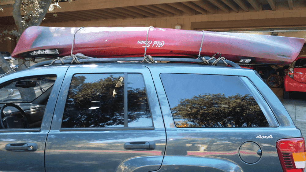

I'm asking these questions because my wife recently got back into kayaking, and we figured out a way that she could lift her 10 foot 50 pound kayak onto the roof of my Jeep Grand Cherokee to head out on weekends on her own to the local kayaking places. We came up with a routine where she uses her kayak cart thingy to get it out to the Jeep, and lifts half the weight of the kayak from behind the Jeep to put the front of the kayak on the back top edge of the roof of the Jeep (with appropriate low-friction blankets placed on the roof rack).
She is then able to lift the back of the kayak and push it up onto the top of the Jeep roof rack and then secure it with ropes. There are lots of intermediate tricks that we've figured out along the way, but that's the main idea of lifting and pushing the kayak up onto the roof of the Jeep. A similar procedure is used in reverse for unloading.
So would something like this work for you? If you can lift half of the 125 pound weight and you have a good roof rack on the van, this might be a lot simpler than what you were asking about. It gets even simpler if you were counting on a partner to help you get the boat from the van to and from the water. :smile:
I think my proposed boat loader will much less strenuous to load a 150 lb boat on to the roof rack, than doing it the way your wife loads her kayak since her kayak weighs 50 lbs.
Thanks much for your suggestion. I appreciate all input.
