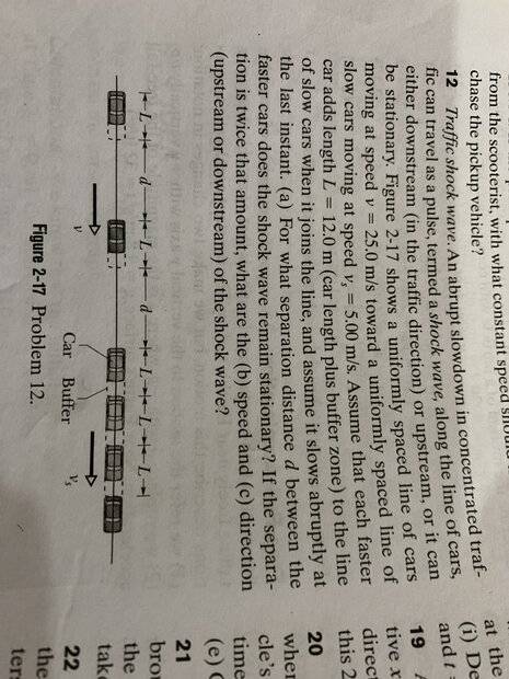

An abrupt slowdown in concentrated traffic can travel as a pulse, termed as a shock wave, along the line of cars, either downstream (in the traffic direction) or upstream, or it can be stationary. Fig shows a uniformly spaced line of cars moving at speed v =25 m/s towards a uniformly spaced line of slow cars moving at speed vc =5m/s. Assume that each faster cars adds length L =12 m(car length plus buffer zone ) to the line of slow cars when it joins the line and assume that it slows abruptly at the last instant. a) For what separation distance d between the faster cars does the shock wave remain stationary. If the separation is twice that amount, what are the b)speed and c)direction (upstream or downstream )of the shock wave?
v= distance /time
I don’t get where exactly the lengths start and end in figure.
They have drawn each car with an imaginary buffer zone in front. This reflects the spacing that will exist once the cars have queued up in the slow line.
We are not given the true length of the cars from front bumper to rear bumper. Nor do we need to know that number.
We are asked to compute distance ##d## which extends from the front end of the buffer zone to the rear bumper of the next car to the front while the cars are queued in the fast line.
Since you have shown no work, I will not attempt to give any hints on how to proceed.

jbriggs444 said:
We are asked to compute distance d which extends from the front end of the buffer zone to the rear bumper of the next car to the front while the cars are queued in the fast line.
So the time it takes for the slow cars to move one L is same as the time taken by the fast cars to travel L(assuming we are measuring the distance traveled from how much the rear wheels of the car travels)+d. That’s how the shock waves will be stationary.
For the second part, the fast car travels L+2d and at the same time slow cars travel distance >L. Then what should I do?
The mental image that I would pursue is flow rate.
You have an upstream flow into a boundary. You have a downstream flow from a boundary. You can ask how fast the boundary must move to ensure that the two flow rates are identical.
My inclination would be to introduce two new named constants into the problem -- the density of the upstream flow (##\rho_u##) and the density of the downstream flow (##\rho_d##). That will keep you from getting bogged down in details when you write down the equation that equates the two flow rates.
What is a boundary, flow, density of flow? I don’t understand !
A boundary is where one thing ends and another begins. In this case, the relevant boundary would be between the front of the line of fast cars and the back end of the line of slow cars.
A flow is a rate at which stuff passes through a boundary. In this case could be measured in "cars per second".
Density often means mass per unit volume. But the term is more general than that. It can be a generic measure of how much stuff you have compared to how much space you have to hold it. In this case it could be measured in "cars per meter"
