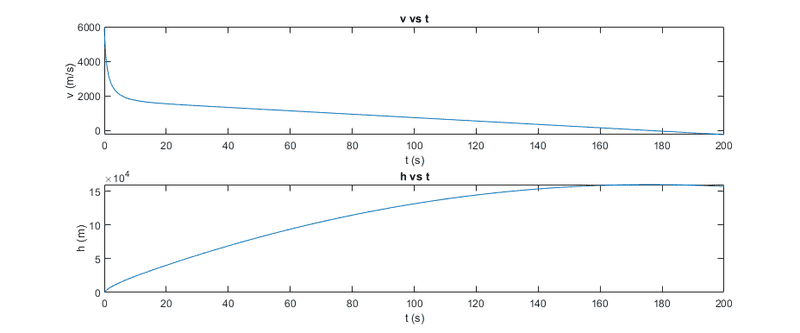

Okay, let's simplify the problem.
What speed is required to throw a 1500 kg container from the sea level up into air to reach 160 km altitude and then fall down? I just want to see some numbers without getting too deep into efficiency, orbit, etc. Think about a 1500 kg container being accelerated below sea level and at the sea level the thrust is cut off, so the container continues to fly up and reached 160 km, then falls down. What speed has to be reached at sea level, so the container reaches 160 km?
Roughly 1750 m/s, but that ignores drag from the atmosphere and some other things that are minor and aren't worth talking about if you just want a rough estimate.

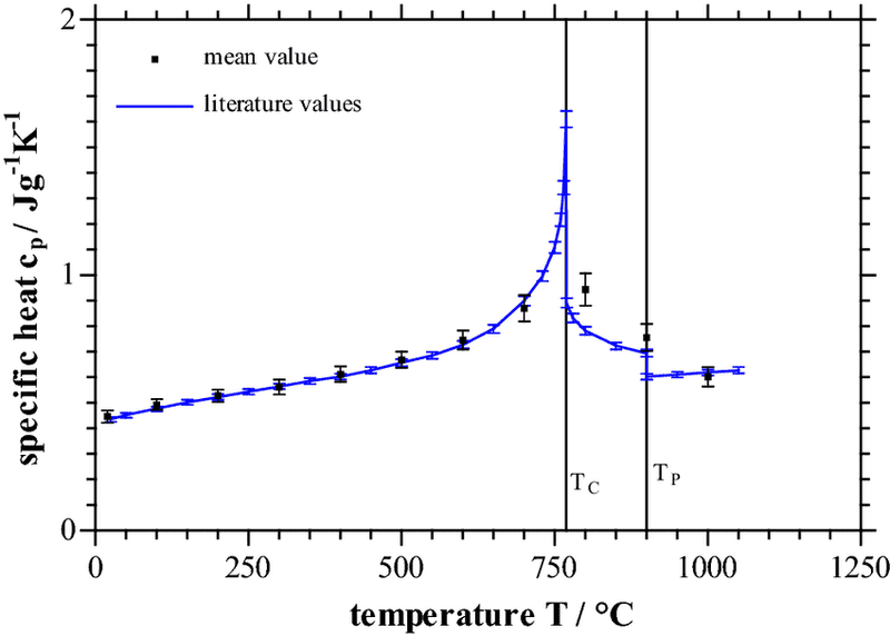

Assuming your container is 100% iron and it's a rigid sphere with a diameter of 0.7m. It would have a drag coefficient (Cd) of 0.9 for most of its journey. Earth has a scaled height of 8400m, and air density is 1.29, g is 9.81 near Earth, assuming no other factor changes (temperature, gravity etc.). Using the drag equation F=0.5Cdρv2, a quick Matlab run gives 5933 m/s initial speed, it takes about 175sec to reach 160km.
Btw the energy it lost to heat alone is 91%, enough to melt the thing like 20 times. This is also why some think the infamous nuclear manhole never made it to outer space. edit: And it's also why we use rockets and planes to leave the dense atmosphere because being fast on the ground sucks.
(edit: You should consider something better for such speed, like a cone or a sabot.)
(edit 2:if you are still thinking about having 7800mps at 160km, the answer is 27879.37 m/s)

Zybex said:
The direction of the velocity is perpendicular to Earth's surface. And by initial speed I mean a sudden thrust, after which there's no thrust at all.
Zybex said:
SpinLaunch is just another scam project that exists only because investors and sponsors have no idea about physics. Just like Mars One, SpinLaunch will cease to exist pretty soon without launching a single satellite, and sponsors will just lose all invested capital.
From what you write in the first quote (nonsense) , I can't see how you can possibly feel qualified to make the comments in the second quote. If you want to be taken seriously, you should at least have some reference to justify your dismissal of Spin launch.
But I wouldn't invest my money in spinlaunch.
