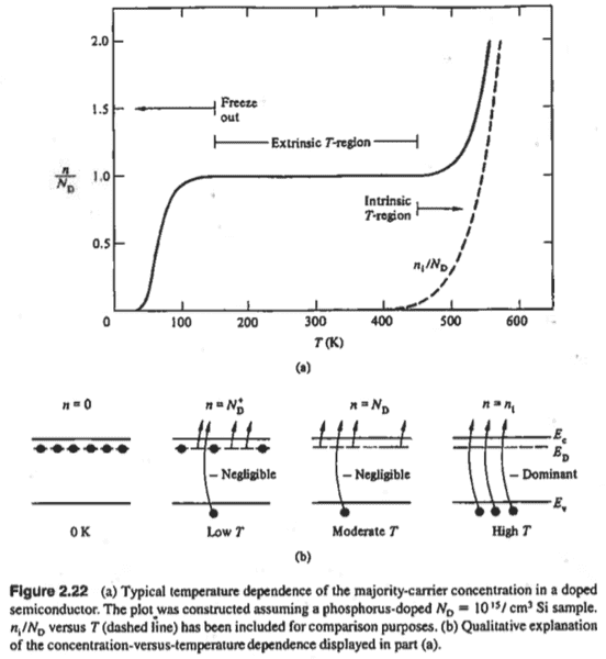

I'm reviewing device physics and I would like to understand how majority and minority carrier concentrations for both N- and P-type substrates change with temperature. My reference, Pierret's Semiconductor Device Fundamentals, has this figure:

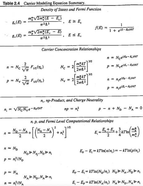

and I want to generate curves for all cases. However, I'm only given these equations

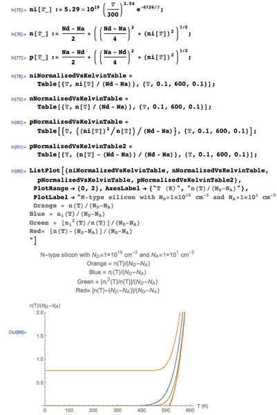

which only seem to cover the extrinsic and intrinsic regions; it doesn't work for "freeze out". Here is what I get using the "n, p, and Fermi Level Computational Relationships":
Mathematica notebook download link:
https://drive.google.com/open?id=0ByhrqgHUHYVjaVdHM3UwNUlWSHc
which obviously does not match the figure above. I also wonder how the characteristic looks like for minority carriers, and I would like to repeat the figure for the P-type substrate case.

Hi,
The problem is with the formula for n, (that is the first formula under "n, p and Fermi level computational relationships"). This formula is valid only if all the donor and acceptor states are fully ionized. Multiply ##N_D## and ##N_A## by the probability that the level is ionized (use Fermi-Dirac statistics and consider degeneracy of the level) then you should get the freeze-out
