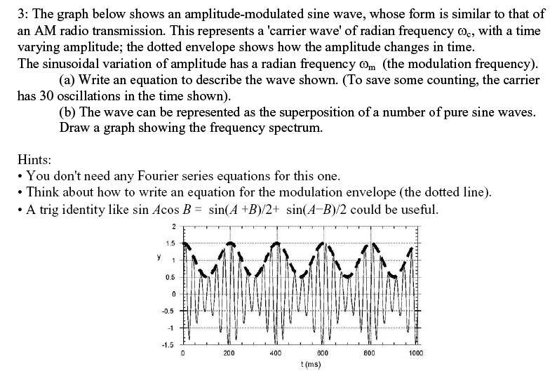

The carrier wave is by inspection [tex]0.5 + cos(10\pi*t)[/tex] and the other would be [tex]1.5*sin(60\pi*t)[/tex].
I'm not entirely sure what we're supposed to graph for the second part, the frequency spectrum. Any help?
Hmm good question
can anyone help please
