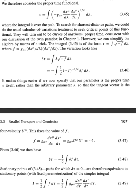

Trying to understand a trick Carroll uses to derive the geodesic equation by extremizing proper time
On pages 106-107 of Spacetime & Geometry, Carroll derives the geodesic equation by extremizing the proper time functional. He writes:
What I am unclear on is the step in 3.47. I understand that the four velocity is normalized to -1 for timelike paths, but if the value of f is fixed, how can we vary it at all?
I don't much care for that sleight of hand either. It's not necessary. Crunching through with either EL equation is not excessively difficult (and one may even learn a little bit about the properties of homogeneous functions). Every serious student of GR should do it. :oldsmile:
In the 1st case (with ##\sqrt{-f}\,##), one finds that the 4 EL eqns are not all independent and one cannot write those EL eqns in the form ##\,\ddot x^\mu = \dots\,##.
In the 2nd case (with ##f##), one finds EL eqns which, when contracted with ##\dot x^\mu##, give an auxiliary eqn of the form ##df/ds = 0##, i.e., ##f = const##, and one can choose the constant depending on whether we're working with timelike, lightlike or spacelike paths.
Likes jbergman and vanhees71
I disagree that there is sleight of hand here. You are well within your right to reparametrise the world line such that ##f## becomes a constant of motion and when you do the variation of the expression eith the square root reduces to the same EL equation as that without.

It is not about not varying it. It is about choosing a reparametrization of the curve such that it is constant when solving the equations of motion. It is easy to show that the proper time is invariant under such reparametrizations.
The square root action is reparametrization invariant. The energy functional is not.

Orodruin said:
This is besides the point. The world lines are the same.
Well, the real point is that Carroll doesn't justify why one can do this which is bad pedagogy. No one is disputing the second point but a valid argument should be given like in @vanhees71 notes on special relativity.

The value of f is fixed at -1 on the geodesic path, which is the solution of the variational equations. It's not precisely constant and equal to -1 for paths near the geodesic path, but it's close to -1. One can imagine expanding the difference in f along a nearby path by some multivariable taylor series. What's important is that 3.48 is correct to the first order in ##\delta f##. It doesn't need to be correct to higher order. A first-order change in f will contribute only second order terms to the results of 3.48. It's not a biggie though - if you don't like this result, with enough effort you can proceed without using this trick.
Likes Orodruin
It's really about getting rid of the square root in the action. Extremizing the functional ##\int d\lambda \sqrt{f(\lambda)}## is equivalent to extremizing the functional ##\int d\lambda F(f(\lambda))##, where ##F(f)## is an arbitrary strictly increasing function. Choosing ##F(f)=f## gives the desired result, without fixing anything. However, the new functional is no longer invariant under reparametrisations ##\lambda\to\lambda'=h(\lambda)##. Hence we think of it as a functional with fixed ##\lambda=\tau##, but this should not be viewed as a fixing of ##f(\tau)##.

Consider the functional
$$A=\int d\lambda \, F(f(\lambda))$$
where ##F(f)## is an arbitrary function obeying
$$\frac{\partial F(f)}{\partial f}>0. \;\;\;\;\; (1)$$
Since
$$\delta \int d\lambda \, F(f(\lambda))= \int d\lambda \,\delta F(f(\lambda))$$
the functional ##A## is extremized when
$$\delta F(f(\lambda))=0.$$
But
$$\delta F(f(\lambda))=\frac{\partial F(f)}{\partial f}\delta f(\lambda)$$
so (1) implies that the functional ##A## is extremized when
$$\delta f(\lambda)=0.$$
Thus, the extremization of ##A## does not depend on the choice of ##F##, provided that it obeys (1).
