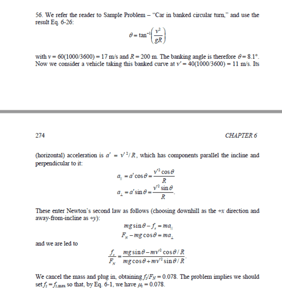

The question is from Fundamental Physics 10th Edition, Walker Resnik Holiday:
A banked circular highway curve is designed for traffic moving at 60 km/h. The radius of the curve is 200 m. Traffic is moving along the highway at 40 km/h on a rainy day.What is the minimum coefficient of friction between tires and road that will allow cars to take the turn without sliding off the road? (Assume the cars do not have negative lift.)
##N cos \theta = mg , N sin \theta = m v_1 ^2 /r##
##F_s = μ F_N ::: Friction = μ N##)
## \theta = arctan (v^2 / rg) ##
[/B]
I solved the problem like this: if we think the slope of the road is θ, and if we think when the road is rainy, the friction is zero and velocity is ##v_1## and when the road is not rainy the coefficient of friction is μ and velocity is ##v_2##, we will have: (N is the force of the road on the object that is normal to the road)
Rainy:
Dry:
## N sin \theta + N μ cos \theta = m v_2 ^2 / r##.
##N μ cos \theta## is the horizontal part of the friction force. because the friction itself will be directed along the road, the horizontal part that is directed along the center of the circle is ##N μ cos \theta##.
by using the rainy equations and dividing them by m, we get:
##v_1 ^2 / r + g μ = v_2 ^2 / r## and from this by changing km/h to m/s we get ##μ=0.078##
The answer of the book is the same but the solution is completely different. I want to know whether my solution is acceptable or not.
Despite the description of the road as "rainy", there is friction in that case. Since the road is designed for traffic moving at 60 km/h, at that speed friction is zero. But not at other speeds.
The first step is to find the banking angle of the road.
I think your method is close/ok but the description/explanation of the two cases is wrong.
When they say the road is "designed for 60kph they mean the bank angle is set so that no frictional force is required at that speed under any conditions (wet or dry). You wrote equations to describe that situation but you said the reason there was no friction was because it was wet. In fact no friction is required at 60kph wet or dry.
Then you calculated the coefficient of friction needed at 40kph. You said this was in the dry but actually the road state doesn't matter (as long as it has that coefficient of friction it doesn't matter if its wet or dry).
Doc Al is right. The best procedure is probably to calculate the bank angle but I guess technically you don't need is as it disappears in the wash as you found out
The rain is irrelevant in this solution. Yes rain may lower friction, but you are only interested in finding the critical value of friction that makes the car slide off the road. What causes that friction is a different question.

Hi Titansarus. Welcome to PF!
In my view, yours is a better solution because it is clearer and works it out from first principles. The reasoning in the book solution seems backward to me. The 8.1 degree angle seems to be the angle that a car, without friction, traveling at 60 km/hr would be able to make the turn. So the car traveling at 40 km/hr at that angle would slide down the curve unless there was a friction force preventing it from sliding down.
At 40 km/hr and no friction, the angle of 3.6 degrees would allow the car to make the curve. At 60 km/hr, a force of friction would be required to keep it from sliding up off the road.
I haven't worked it out but maybe the coefficient of static friction in both those cases has to be .078 and that is why your answers agree.

Andrew Mason said:
The 8.1 degree angle seems to be the angle that a car, without friction, traveling at 60 km/hr would be able to make the turn. So the car traveling at 40 km/hr without at that angle would slide down the curve unless there was a friction force preventing it from sliding down.
That's correct and is exactly what the solution describes. Why is the book's reasoning backward?
Because at 8.1 degrees and no friction, the cars would be sliding down the slope at only 40 km/hr, which is contrary to the stated facts. At 3.6 degrees, the cars traveling at 40 km/hr would make it without friction (i.e. in the rain) but cars traveling at 60 km/hr would need a dry surface with friction to keep from flying off, which is consistent with the stated problem.

Using trigonometry, I get this formula for mu_k: $$\mu_k = \tan(\tan^{-1} {v_0^2 \over rg} - \tan^{-1}{v_1^2 \over rg})$$
@titansarus, you wrote ##N \cos\theta = mg## but that is not correct. ##N \cos\theta < mg##. This is because friction is holding the car up as well, so the normal force has less of a job to do. At least, that's how I understand it.
@titansarus was confusing rainy with zero friction, hence the equation.
Or perhaps more simply
##\frac{v_1^2-v_2^2}{(gr)^2+(v_1v_2)^2}gr##.
Either way, we see that swapping the two speeds simply switches the sign of the answer, which is equivalent to having friction act the other way.
This is why the OP's misinterpretation of the question still got the right answer.
