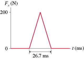

A 500 g cart is released from rest 1.0 m from the bottom of a frictionless, 30° ramp. The cart rolls down the ramp and bounces off a rubber block at the bottom. The figure (below) shows the force during the collision.
After the cart bounces, how far does it roll back up the ramp?

Next, [itex]J = F\Delta t = \Delta P[/itex]
[itex]F\Delta t = 200 * \frac{26.7}{1000} = 5.34 Ns[/itex]
[itex]5.34 Ns = \Delta P = | mv_0 - mv_f |[/itex]

Your basic concept of the impulse appears correct. Now, look at the shape of the force profile during the collision. One way of dealing with this is to ask what is the average magnitude of the force during the 26.7 msec collision and then multiply that average by the collision duration. Another way is to find the total area of the force profile during the collision, which gives the magnitude of the impulse (if you've had calculus, we'd say that the integral of F(t) with respect to time equal J).

Tried the thing with a different value for J (Dividing old value by 2, since the area is a triangle), still got a wrong answer.
OK, I guess we're also agreed now that the impulse is given by
[itex]F\Delta t = 200 * \frac{13.35}{1000} = 2.67 Ns[/itex]
[itex]2.67 Ns = \Delta P = | mv_0 - mv_f |[/itex]
Where [itex]v_0, v_f[/itex] are the velocities immediately before and after rebounding, respectively.
The velocity before rebounding, [itex]v_0[/tex], we just calculated to be -3.1305 (The [itex]v_f[/itex] of rolling down the ramp).
If we divide the impulse by the mass of the cart, we get a velocity change of
(2.67 kg-m/sec) / 0.5 kg = 5.34 m/sec .
Since the cart was headed downhill at 3.13 m/sec just before impact, the velocity of the cart after the collision is
-3.13 m/sec + 5.34 m/sec = +2.21 m/sec (so plainly the collision with the bumper is inelastic).
I'd avoid using the absolute value since that leads to ambiguous solutions, one of which is unphysical. The important point is that if we call the cart's velocity negative before contact, the force from the bumper being positive means that the acceleration on the cart is positive and thus directed uphill. So a positive velocity change would be added to a negative velocity, giving here a positive (uphill) velocity after contact.
I'm taking it from the method you used to finish the problem that you've had kinematics, but not energy yet. Have you had the "velocity-squared" equation? (You are using a version of it here: [itex]v_f = \sqrt{0 + 2ad}[/itex]). The acceleration back up the slope is -g sin 30º , as you remarked earlier, the initial speed is now 2.21 m/sec and the final speed will be zero. So we have
(v_f)^2 = (v_i)^2 + 2ad giving
0 = (2.21 m/sec)^2 + 2 · (-4.91 m/(sec^2)) · d ,
d being the distance the cart runs back up the slope.
As I look at your step involving absolute values, I believe the value you'd want to use is
[itex]2.67 Ns = -1.56525 - 0.5*v_f[/itex] , rather than -2.67 N·sec . (As I say, my preference is to avoid absolute value expressions and to look instead at directions of the velocities and directions of the changes.)
