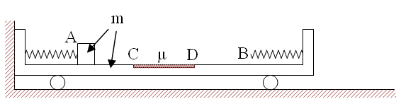

A cart of mass m is adjacent to a wall. it has a mass, also m, attached at point A to a loose spring of constant k. an identical spring is on the opposite wall. the floor of the cart is frictionless apart of the middle part CD with equivalent μ. a force F is applied to the mass and then released. at point B of the other loose spring m has relative velocity vrel.
1) What's the cart's velocity relative to the floor at the moment m hits the right spring.
2) What's the max acceleration amax of the cart from the beginning till m stops completely relative to the cart.
3) What's CD's length?
4) What is the final velocity of the cart?
5) At what distance from C m finally stops on the rough surface CD.
6) What's the impact the mass applies on the cart at the time described in question 2.
The variables are given values:
m=200[gr], μ=0.5, k=500[N/m], F=40[N], vrel=2[m/s]

The velocity of m at A:
$$\left\{ \begin{array}{l} \frac{1}{2}kx^2=\frac{1}{2}mv_A^2 \\ F=kx~\rightarrow~x=\frac{F}{k} \end{array}\right.$$
$$\rightarrow~v_A^2=\frac{F^2}{mk}$$
1) vm is the boxe's absolute velocity, vM is the cart's. conservation of momentum from the beginnig+relative velocity:
$$\left\{ \begin{array}{l} mv_A=mv_m+mv_M \\ v_m=v_M+v_{rel} \end{array}\right. ~\rightarrow~v_M=\frac{v_A-v_{rel}}{2}$$
2) When m reaches B if works, from there on, on both springs, who's equivalent is ##k_{eq}=\frac{k}{2}##
In the COM's frame, after the box reached B, when the box stops the total kinetic energy which is contained in both, the box and the cart and the given relative velocity zeroes and it enters the equivalent spring:
$$E_k(tot)=\frac{1}{2}\overline{m}V_{12}^2=\frac{1}{2}k_{eq}x^2~\rightarrow~\frac{m}{2}v_{rel}^2=\frac{k}{2}x^2~\rightarrow~x^2=\frac{mv_{rel}^2}{k}$$
The cart's acceleration:
$$F=k_{eq}x=m\cdot a_{max}~\rightarrow~\frac{k}{2}v_{rel}\sqrt{\frac{m}{k}}=ma_{max}$$
$$a_{max}=\frac{v_{rel}}{2}\sqrt{\frac{k}{m}}$$
3) The difference in the total kinetic energy in the COM frame is the loss on the rough surface. since at the beginning the relative velocity is the one i found as the velocity at A:
$$\Delta E_{k(tot)}=\frac{1}{2}\frac{m}{2}\left[ v_A^2-v_{rel}^2 \right]=mg\mu\cdot x_{CD}~\rightarrow~x_{CD}=\frac{v_A^2-v_{rel}^2}{4\mu g}$$
4) Conservation of momentum between the beginning and with their common velocity when the box stops:
$$mv_A=2mv_{com}~\rightarrow~v_{com}=\frac{v_A}{2}$$
5) The energy loss in one pass over CD:
$$E_1=fx_{CD}=mg\mu\frac{v_A^2-v_{rel}^2}{4\mu g}=\frac{m(F^2-mkv_{rel}^2)}{4mk}$$
I divide the kinetic energy at the beginning by E1 to get the number of passes:
$$n=\frac{\frac{1}{2}\frac{F^2}{k}}{\frac{m(F^2-mkv_{rel}^2)}{4mk}}$$
After substituting the numbers i get n=2.28, so the last pass is:
$$0.28E_1=mg\mu\cdot x~\rightarrow~x=...$$
But is there a general method without substituting actual values? in this case n was small but...
6) The impulse the box exerts on the cart is the cart's final velocity, since at the beginning it was at rest:
$$P=mv_{com}=\frac{1}{2}mv_A$$

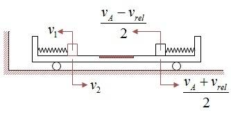

The velocities at B the first time are:
$$v_{M(B)}=\frac{v_A-v_{rel}}{2},~~v_{m(B)}=v_{M(B)}+v_{rel}=...=\frac{v_A+v_{rel}}{2}$$
But since in elastic collision with equal masses the partners change velocities between them the velocities are as they are in the drawing.
The velocities at A again (second time) are, in correspondence with the drawing, v1 and v2. from conservation of momentum with the beginning: ##mv_A=mv_2-mv_1~\rightarrow~v_2=v_A+v_1## and the relative velocity is ##V_{12}^2=(v_2-v_1)^2=v_A^2~\rightarrow~V_{12}=v_A##
Is it logical?
Which ways are you defining as positive for v1 and v2 there? According to your momentum equation you are taking them as positive in opposite directions, so the relative velocity would be v1+v2.
$$mv_A=mv_2-mv_1~\rightarrow~v_2=v_A+v_1$$
$$V_{12}^2=(v_2+v_1)^2=v_A^2~\rightarrow~V_{12}=(v_A+2v_1)^2=v_A^2+4v_Av_1+4v_1^2$$
After the box passes on the rough surface, after leaving B towards A, it's velocity is reduced:
$$\left\{ \begin{array}{l} v_1^2=v_B^2-2ax_{cd} \\ mg\mu=ma~\rightarrow~a=g\mu \end{array}\right.$$
$$\rightarrow~v_1^2=\frac{1}{2}(3v_{rel}^2-2v_Av_{rel}-2v_A^2)$$
v2 from the momentum, initial and contemporary situation:
Complicated, is it the way, should i now substitute numbers?

I did not mean that you had to work out the max acceleration of the cart when the block returns to A, just that you needed to tighten up the argument.
If you consider the reference frame of the common mass centre, the accelerations don't change (since it's still an inertial frame) and since the energy (in that frame) does not increase the relative velocity when back at A cannot exceed the relative velocity when leaving B. At each locally max acceleration, the system is at rest in this frame.
