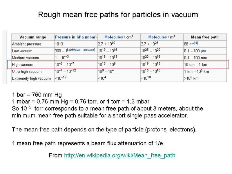

berkeman said:
Bob -- his article mentions construction intended for 10-5 torr, and doesn't look to be able to support lower than that. Is that a problem?
Also, I'd be worried about implosion issues with the glass fittings that are described in the article he is following:
http://www.science-project.com/_members/science-projects/1971/08/1971-08-fs.html
A beamline pressure of 10-5 torr corresponds to a mean free path (or a 1/e beam flux attenuation length) of about 8 meters. See calculation in thumbnail. This is ok for a single-pass accelerator like this project, but not for a small cyclotron (multi-pass) which has a much longer beam path length in vacuum.
The 1½" diameter ID pyrex glass tube has to hold off 15 psi radial compression, and if the pyrex tube wall is ⅛" thick, the azimuthal wall compression is 15·1.5/(2·0.125) = 90 psi. This is very safe. Compare to the glass neck on a cathode ray tube. The brass (or aluminum) electrodes should be designed to provide a lip to mechanically support the ID of the pyrex tube, provide alignment, and a good vacuum sealing surface.
Bob S

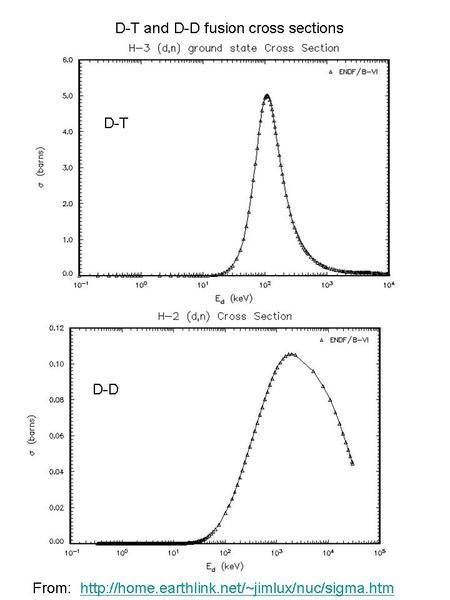

These two tables
http://home.earthlink.net/~jimlux/hv/spherev.htm
imply that you need a 100-cm dia sphere to get to 900 kV. A gap spacing of 8" implies a voltage of about 500 kV.
The two cross section plots in the thumbnail imply that you need ~ 200 keV to get full neutron yield for a D-T (deuterium-tritium) reaction (5 barns at ~ 100 keV); ~ 1 MeV to get low yield (~ 0.1 barn) for D-D.
( 1 barn = 1 x 10-24 cm2 per atom)
Bob S
