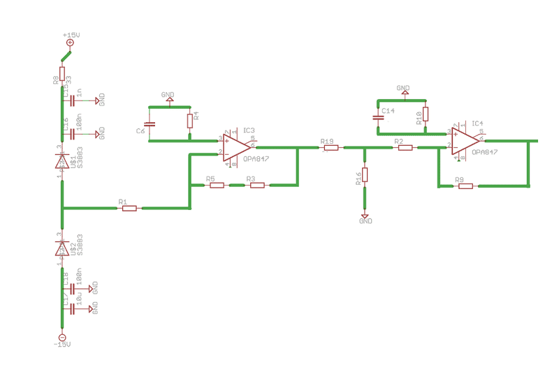

Hi All,
I have made a photodetection circuit that is supposed to work in a broadband-freq regime (from a few kHz to around 100 MHz). I essentially subtract the currents of two PIN photodiodes (that are reverse biased), and amplify this difference (I_diff) in two stages - the first is essentially a transimpedance stage, while the second enhances the voltage gain.
This is also known as homodyning (pardon me, if you were already familiar with the term). Both stages are opamp-based inverting configurations. I've attached a pic of the schematic, conveying the main idea (opa 847 is the opamp I'm using).
Currently, I am trying to get the DC operation of the circuit to work. I've the individual stages running quite okay -- by adjusting the resistances at the non-inverting inputs (R4 and R10 in the pic), I can get the individual DC offsets below 40 mV (with no input signal i.e.).
However, if I cascade them, then the output of the second stage goes beyond 4.0 V ! It also seems to find some capacitance, because this voltage seems to discharge (very) slowly. And it probably is also loading the earlier stage.
Can anyone tell me if the resistive bridge between the two stages (please see image) could largely be the culprit for this behaviour? If yes, how should I choose the values so as to minimize? Currently, I've tried R19=R16=100 ohm, R2=50 ohm and R9=4.0K and R3=R5=1.8K.
I've designed (and am testing) this circuit on a PCB. I've tried to avoid all possible pitfalls I knew about -- all the components are SMD, I am using enough bypass capacitors for the opamp supplies, the supply tracks are on one side of the board and the other side is almost 80% GND plane. I can post an image of the board too, if required.
I would be very grateful to get your views and suggestions!

Welcome to the PF. A design goal of DC to 100MHz is quite ambitious. Why do you need such a wide range? I'd AC couple the two stages if you can remove the DC requirement.
Hello!
Thanks very much your quick response.
I am using a pulsed laser with a repetition rate (fR) of ~76 MHz & need to resolve between consecutive pulses. So, I need the detector bandwidth to be > fR, thanks to Mr. Nyquist!
Practically speaking, a bit of aliasing wouldn't be frightfully bad, so it might suffice even if it's around 70 MHz... however, for now, I am grappling with the DC operation blues... high frequency stuff will be a pain for sure (and the forum will see more posts then, quite likely) but later.
-Nitin

So what's the problem with putting some 1 MHz high passes into your design and pulling the inputs to ground at dc frequencies?
Exactly. There's no reason for this amp to have high gain at DC, and lots of issues with making that happen.
I surely did intend to use a high pass filter at the final output of the (homodyne) detector, however, the current DC offset of ~4.0 V at stage II output is rather high too and should be addressed in my opinion, as it possibly stems from some loading. In other words, it isn't merely a simple DC gain...
Nevertheless, your idea still probably is worth a try.. so I'll try to replace the resistive-bridge by a HPF of ~1 MHz cut-off... will let you know if it helps!

I am puzzled at the terminology you are using.
You have two photodiodes in series so they form a voltage divider.
You have two voltage amplifiers with apparently a lot of gain (although R1 is not given a value). The second stage has a gain of about 26.
Homodyne detector is a valid term but it usually refers to a very different device to what you are showing in your diagram.
It seems very likely that the series diode arrangement would be able to introduce a DC component at the input which would get amplified through the opamps. A capacitor in series with R1 should help with this.
The photodiodes might seem to be in series, but in a high-frequency (or even non-DC) picture, the +ve and -ve supplies will be essentially ground, so the photodiodes (along with their junction capacitance) will be in parallel.
About the use of R1, yes it creates a bit of confusion, but ideally speaking, it is supposed to be zero and the first stage is then a true "transimpedance" amp... and so, I am actually amplifying the difference of the two photocurrents. And as far as I understand, this is the principle behind a balanced optical homodyne detector. What I know is that the frequency mixing is not explicit here (as in the microwave implementation), so maybe that's what raises the confusion? The former as such is done by (optically) interfering the signal with the local oscillator.
On the circuit board, I am using a < 10 ohm SMD resistor for R1... the idea being to get another pseudo-feedback capacitance from it, so that it makes a high pass filter with the shunt resistance of the photodiodes... which will hopefully prevent the phase margin to go to 180 deg. This mightn't be a great idea, but I think I should be able to even use a 0 ohm resistor. But in any case, I'll be happy to get comments on any of the aspects.

The first amplifier has a voltage gain of (R3 + R5) / R1. So, that is 3600 ohms / R1.
So, choose R1 and choose your consequences. That will be the amplifier's DC gain as well.
I would make R1 about 360 ohms and settle for a gain of 10.
The photodiodes are in series from a signal point of view.
Their source impedance is the result of putting them in parallel, but you presumably have different light sources striking the two diodes.
So at anyone moment, they have different resistances and will divide the supply voltage accordingly.
This will give you a varying voltage which will be amplified by the first opamp.

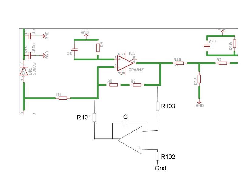

I attach a thumbnail jpg of what I would use to get rid of dc drift. I would have preferred something I could have pasted into SPICE. I don't have your resistor values, so my initial suggestions are R101 = 10 times R1, R102 = R103, R103 = R5 + R3, and integrator time constant = C times R103 = 1/w = 1/ 2 pi fhipass.
Thanks Bob. And apologies for not giving the resistance values earlier.
Anyhow, as of now, I think focusing on getting a good overall frequency response is a better idea, compared to doing just a DC balancing, as I've explained in the last paragraph of my previous post. So I'll probably be asking questions pertinent to that, soon.
