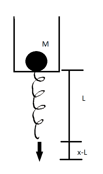

Q1) But the solution mentions that h = x-l , why is this? :
With the diagram I have drawn ( attached), I cannot understand why h= x-l
I'm assuming the height from which it is released intially is zero. But does the ball have to gain a potential energy of the height it is displaced by (x-l) ? I don't quite understand why this.
1/2 (k(x-l)^2) = (1/2) mv^2 + mg(x-l)
when gives v velocity as the maximum velocity reached. It is assuming the greatest velocity reached by the ball is the instant it leaves the catapult, then it must travel a vertical distance of x-l to do so, and thus, gains Mg(x-l) as well as KE. But I don't understand why the maximum velocity is when the ball leaves the catapult.

User1265 said:
possessing maxmium kinetic energy (thus speed) at the moment of release.
Depends what you mean by the moment of release. What forces act on the mass when the spring is relaxed?
The moment the ball leaves the catapult being the moment of release. Gravity acts on the mass when the spring is relaxed I believe.

You have a choice in these problems:
1) Take the starting point to be the natural equilibrium point of the spring. You put the mass on the spring and push it down to a displacement ##x_0##, say.
2) You put the mass on the spring first and take the starting point as the equilibrium with the spring supporting the mass. Then, you push the mass down by a displacement ##x'_0 < x_0##.
You should be able to do it both ways, but you need to be careful about GPE.
Which would be when the spring is length L, right?
Yes, so will its upward speed then be a maximum or increasing or reducing?
Your diagram doesn't seem to make sense for sending the ball upwards (which I assume is the intended interpretation). Either the spring should be compressed to length x or the top of the spring is fixed and the mass is in a cup at the lower end.

At the point the ball leaves the spring I believe the upwards speed would be reducing due to the force of gravity on the ball.
But what I don't understand is why h=x-l ,
why is the gravitational potential energy mg(x-l) when ball leaves the spring?

How are ##x## and ##L## defined?
I assume that ##x## is the total compression of the sping and ##L## is the compression of the spring under the mass of the projectile. The compression point ##L## is considered the launch point. The GPE gained from the maximum compression to the launch point is ##mg(x-L)##.
Note that an alternative approach is to take the equilibrium point at ##L## to begin with. Then the compression is ##x - L##. The spring force in this case is reduced by the gravitational force and these forces and energies cancel out. In this case, therefore, you can consider the reduced PE of the spring only and ignore GPE.
You might like to check that the two calculations give the same result.

X is the total length of the spring after compression. L is the natural length. With regards to the latter question, is my reasoning correct for the point of maxium velocity:
when ball loses contact with the spring, it's velocity is a maxium for the reason, when the spring is extended down by a extension of X-L and released, the spring's restoring force acts on the ball doing work over a distance of X-L on the ball, (the force decrealine linearly /gradually to zero at the equilibrium- when spring returns to ornignal length L ), and so the spring accelerates the ball up until the point zero contact, and elastic potential energy is transferred to ball is 1/2 (x-l)^2. Velocity at this point must be maximum, as the net acceleration after this point ( i.e in freefall) is in the opposite direction due to gravity.
So it has already lost some speed, right? The question asks
"to what velocity does the catapult now accelerate the ball?"
I take that to mean the maximum speed reached.
