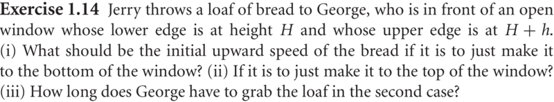

Jerry throws a loaf of bread to George, who is in front of an open window whose lower edge is at height ##H## and whose upper edge is at ##H + h##.
(i) What should be the initial upward speed of the bread if it is to just make it to the bottom of the window?
(ii) If it is to just make it to the top of the window?
(iii) How long does George have to grab the loaf in the second case?

I start by copying and pasting the problem statement as it appears in the text.

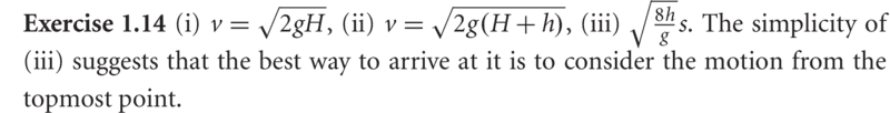

Let me copy and paste the answer from the text.
Request : Where did I go wrong in my calculation in part (iii)?

Yes. So that should mean that the time available to George ##\Delta t = 2\sqrt{\dfrac{2h}{g}}=\boxed{\sqrt{\dfrac{8h}{g}}}##.

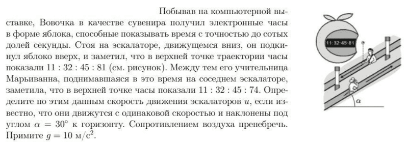

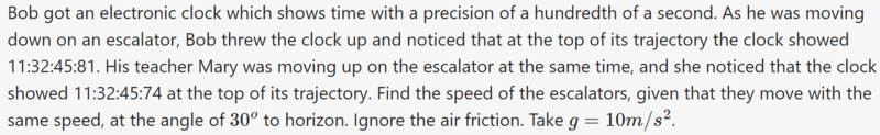

Somewhat OT, this question has reminded me of a question I've received some time ago from a friend. I copy and paste the original and an English translation of it:
Bob got an electronic clock which shows time with a precision of a hundredth of a second. As he was moving down on an escalator, Bob threw the clock up and noticed that at the top of its trajectory the clock showed 11:32:45:81. His teacher Mary was moving up on the escalator at the same time, and she noticed that the clock showed 11:32:45:74 at the top of its trajectory. Find the speed of the escalators, given that they move with the same speed, at the angle of ##30^o## to horizon. Ignore the air friction. Take ##g = 10 m/s^2##.

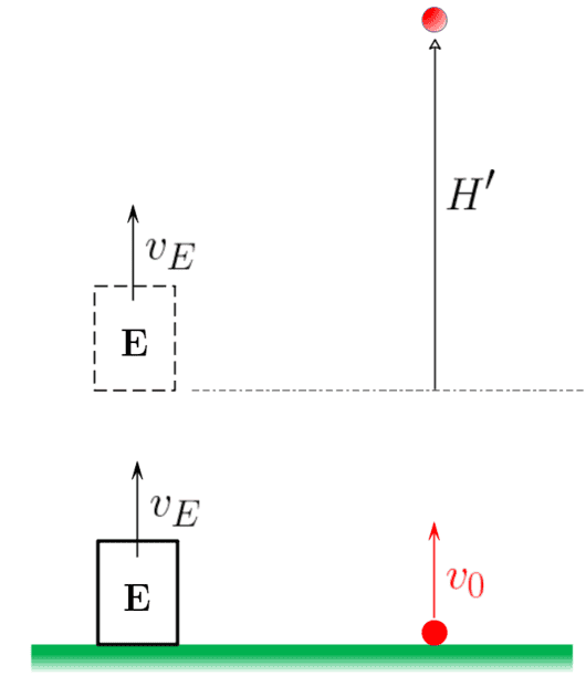

Let me post a simpler problem than the one in post #13 above.
Problem : A ball is thrown with a velocity ##v_0## vertically up from the ground. An elevator was moving up from the ground with a uniform velocity ##v_E \;(<v_0)## at the same instant. What is the maximum height ##H'## that the ball attains in the elevator's frame and when?
Solution : The ball has an initial velocity of ##v'_0=v_0-v_E## in the elevator's frame. Using the velocity-displacement equation (##(3)## above), the maximum height attained by the ball in the elevator's frame is ##\boxed{H'=\dfrac{(v_0-v_E)^2}{2g}}## and the time for this height to be attained ##\boxed{T'=\dfrac{(v_0-v_E)}{g}}##. We note that both of these are less than those obtained in the ground's frame.
Observation : The maximum height attained by the ball in the ground's frame is ##H=\dfrac{v_0^2}{2g}## at a time ##T_H=\dfrac{v_0}{g}##. We note that this time is the same as that in the elevator's frame : i.e. ##T'_H=T_H= \dfrac{v_0}{g}## as a consequence of time being an invariant between two events. The distance of the ball at this height from the elevator would however be different : ##y'(H)\ne H##, the events not being simultaneous. In fact, ##y'(H)=H-v_Et_H=H-\dfrac{v_Ev_0}{g}## by the Galilean transformations.
Request : I would like to ask @Hill or someone else, are my reasoning and conclusions correct? The problem is conceptually good.
It all looks good to me.
