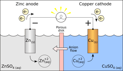

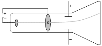

Hello,
In cathode ray discharge tube,negative electrode is cathode and positive electrode is anode.
But in case of direct current circuit, it is the positively charged terminal of a voltaic cell or storage battery that supplies current and anode is the negatively charged terminal of a voltaic cell or storage battery that supplies current.
Why?

It can indeed be a bit confusing and it's a matter of the definition.
Current (positive charge) flows away from the cathode into the electrical circuit.
Mnemonic is CCD: Cathode Current Departs.
Of course in practice we have negative electrons that are the carriers of charge.
And while current flows away from the cathode, equivalently negative electrons flow into the cathode.
It means that for a CRT, we connect the cathode to the negative pole of our power source.
Note that the cathode itself is not the negative pole.
Consequently positive charge flows from the cathode into the power source.
Equivalently, negative electrons flow from the negative pole of the power source into the cathode where they are spit out and fly into the tube.
In a voltaic cell, current flows again away from the cathode.
Consequently the cathode itself is the plus pole of the voltaic cell.
Equivalently, the negative electrons flow from the electrical circuit into the cathode where the electrons bind to positive metal ions in the solution.
