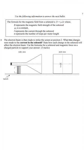

Hi haruspex. Second part of the question here. Would appreciate any advice on this one. The only thing I can come up with is reversing the current of solenoid, but not sure how to prove this with the formulas.
Since haruspex may still be in bed (Australia), can I suggest (1) what effect is there on the mag. force when B is reversed, and (2) does the magnitude of the deflection depend on the magnitude of B?

Thanks rude man, I should be able to figure it out from here...
