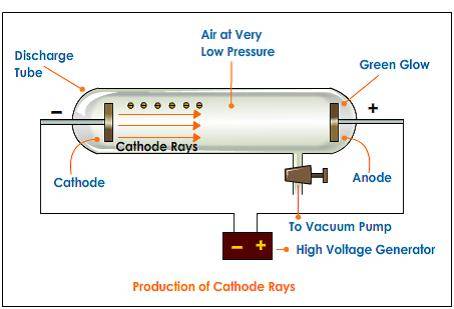

I'm confused at why cathodes are the positive terminal in chemistry but appear to be the negative terminal in physics. I hope someone can clear this up for me.
Definitions:
Anode: An anode is an electrode through which conventional current flows into a polarized electrical device.
Cathode: A cathode is an electrode through which conventional current flows out of a polarized electrical device
Galvanic Cell
Vacuum Tube
cathode-rays-formation.jpe
Going by the definition above, I agree with the galvanic cell "cathode/anode" labels.
However, looking at the vacuum tube, the electrons traveling to the right through the partial vacuum and entering the anode, ie conventional current is leaving the anode which seems to contradict the provided definition.
Likes davidbenari
The definitions describe what happens outside the device.
Inside the CRT, electrons travel from the cathode to the anode.
Outside the CRT, to complete the circuit, electrons travel from the anode to the cathode.
So outside the CRT, conventional current travels from the cathode to the anode.
So conventional current flows from outside the CRT into the anode.
Likes davidbenari
Thank you very much! I finally see the light now :)
