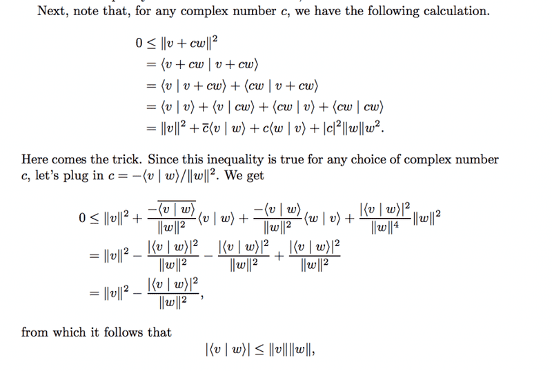

In this proof, at the end, how do you go from
|v|^2 |w|^2 ≤ | |<v|w>|^2
to |<v|w>|^2 ≤ <v|v> <w|w>
I'm struggling to find which properties allow this.
The inequality ##0 \leq |v|^2 - |\langle v,w \rangle |^2/|w|^2## is the same as ##|\langle v,w \rangle |^2/|w|^2 \leq |v|^2##. Do you see it now?
